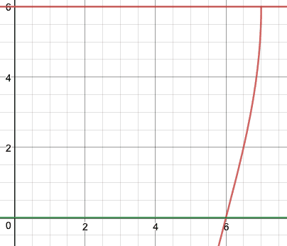

The area bounded by the red and green lines are our area, right? (see thumbnail) If so, then from x = 6 to x = 7 the volume should be
[tex] \int_6^7 2\pi(6-(12/\pi)arcsin(x-6))(6+x) \, dx[/tex]
Correct..?
Correct..?
Looks good to me...

As I understand the problem, the bottom of the "bowl" is the plane formed from rotation the x-axis around the y-axis. Using the shell method, the region of integration is bounded by the lines x = 6, x = 7, and the curve. The shells are generated from thin strips between x = 6 and x = 7, so those are the limits of integration.
If this isn't the region of integration, but is instead the region bounded by the lines x = 6, y = 6, and the curve, then revolving that region around the y-axis gives a whole different solid of revolution, with a different volume. Is there a picture in your textbook of what the solid should look like?

The problem statement as posted isn't clear to me. I've been assuming that the sort of triangular region bounded by the x-axis, the line x = 7, and the curve is revolved around the y-axis. This would make a figure whose outer surface is a cylinder and whose inner surface is concave.
The integral you set up made me think that's what the solid is.
If the inner surface looks the same as the outer surface, then your first integral in post #1 looks fine, but the second integral doesn't. You are apparently using thin vertical strips, but between x = 6 and x = 7, your strips run from the x-axis up to the arcsine curve, which is wrong. They should instead run from the curve up to the line y = 6.
Correct..?
This is even later to the thread.
Here you have the correct height for a shell,
## \left(6-\frac{12}{\pi}\arcsin(x-6)\right)##​
but the radius for a shell is ##\ x\ ## as you had originally.
This gives the following for the volume generated by the portion of the function lying between x=6 and x=7.
## \displaystyle{\int_6^7} \left(2 \pi \left(6-\frac{12}{\pi}\arcsin(x-6)\right)(x)\right) \, dx ##
