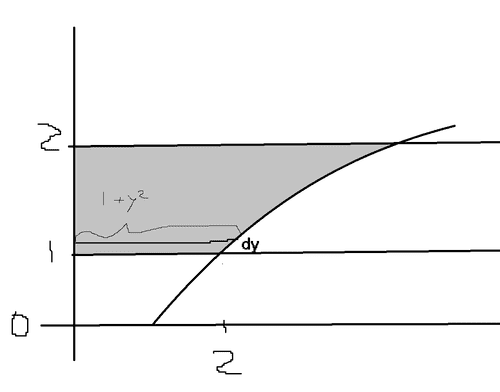

Volume of solid rotated about x-axis x=1+y^2, y=1, y=0, x=0 using shell method
so i set up the integral with
∫2pi(y)(1+y^2)dy from 1 to 2
which is apparently wrong, but i don't know why.
You wrote y=0 as a bound, but I guess you meant y=2.
The formula looks right. What did you get? Do you know what the 'right' answer is?

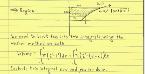

Oh right. My bad I did mean y=2. Well here is my professors solution. If evaluate his answer I get 14. If I evaluate mine I get around 32.
Here is his solution. He seems to be using the washer method.

Your Prof wrote √(1-x), but it should have been √(x-1).
I get the result
[tex] \frac{21 \pi}{2} [/tex]
via both shell (cylinder) and disc methods)
