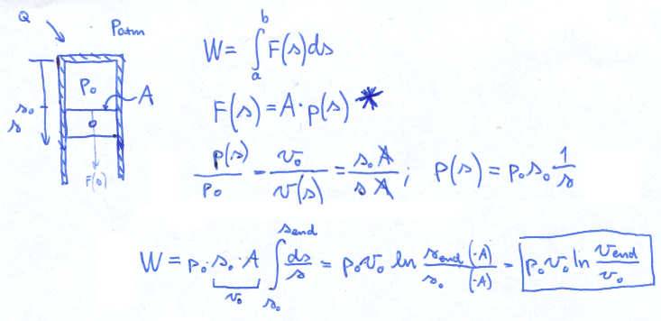

hello.
i can't figure out where I'm wrong. this is the problem:
we have a cylinder, closed with a piston. the absolute pressure inside the cylinder is p0, atmospheric pressure is patm. the air inside expands isothermally to some (specific) volume vend.
i derived the equation for isothermal work directly from this one: dW = F(s)ds.
here it is (sorry for handwriting... uses less time (will learn TeX one day... )):
the final equation seems just fine, but you've probably noticed the big fat asterisk. here's why:
p0 is absolute pressure and it exerts F(s0) on the piston. but there is also patm, which does negative work equal to patm * A * (send - s0). this fact hasn't been taken into account anywhere.
where am i wrong (the thermodynamics probably isn't wrong, right? :) )
