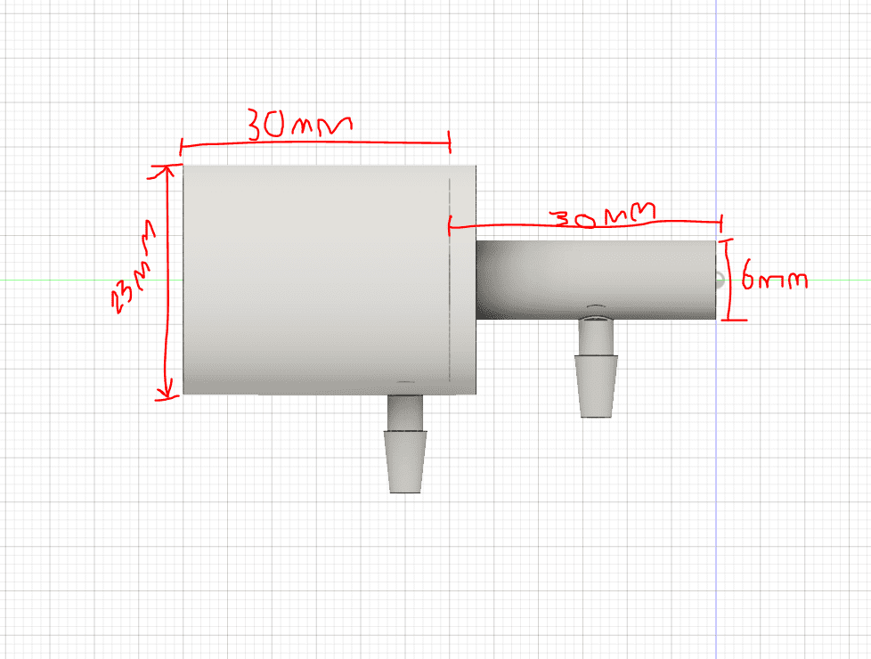

Hi, I have designed a simple Venturi meter to measure pressure differential across to section of the pipe as pictured. However in calculations I am not sure if I am doing something wrong. I am trying to calculate Volumetric flow rate in L/s.
I am using Bernoulli Equation of the Venturi meter as above
From my MPX5010 DP Sensor I am getting a pressure differential of 222.2 pa.
A1 is cross sectional area of first part of the tube = Pi * R^2 = 0.000415 M^2
A2 = Pi* R^2 = 0.0000283 M^2
P = Density of air = 1.225
P1-P2 = DeltaP = 222.2 Pa
Plugging all into the equation above I am getting a volumetric flowrate = 0.000539783 M^3/s
Multiply by 1000 = 0.539783 L/s
Is this correct, is the formula correct ? I have seen multiple different formulas stipulated online.
Thank you
Formula is as it is shown here . What others did you find ?
When I do the calculation I get your result -- but with less digits.
Likes Teeg and Lnewqban
Thanks for your response. Looking further into the topic I think I am not achieving laminar flow and this is my problem, I am going to re design the tube to attempt to achieve laminar flow through the device.
