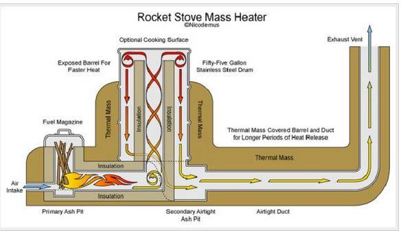

Regarding swirl: I want high velocity but I want the gases to spend some time in the pipe for the secondary burn. There is some smoke in the stream when it leaves the horizontal burn chamber the vertical pipe is well insulated and the high temperature will complete the burn, eliminating almost all of the smoke.
The perlite is a good high temp insulator for mixing into cob and for lightning hypertufa. I stumbled onto hpertufa when I started searching for something to replace plastic plant pots which are now $15+ in the size I want.
Seems I cannot insert a jpg file but since a picture/schematic is worth 1024 words maybe this will give you an idea.

Inserting images is a booger here. Here is a Rocket Mass Heater diagram.

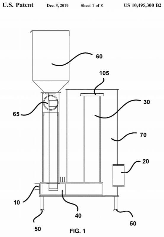

So is the intent of the vortex to slow down the exhaust flow and facilitate more heat transfer out of the exhaust gasses to the piping? Can you comment on what the vortex is supposed to help? And if heat transfer is a goal, why are you using concrete for the heat conducting medium?
Thanks.
Your idea looks a lot like this from Liberator LLC (https://www.rocketheater.com/), except with added thermal mass and without the pellet feeder:
I saw their heater in operation at an energy fair a few years ago. They were getting clean combustion and good heat transfer, which was evidenced by low stack temperature. Their demo model was burning sticks of wood, not pellets.
The amount of heat transfer in this system is almost entirely due to the heat transfer area, and only slightly due to artificially induced turbulence. Keep in mind that anything that induces a vortex or turbulence also increases friction loss in the exhaust gases. Also, you need a minimum stack temperature in order to get combustion air and exhaust gases to flow through the system. The result is that, if you artificially induce a vortex or turbulence, you will need increased stack temperature to get the necessary gas flow rate. The thermal efficiency will decrease.
The inventor told me that their patent only covered a design feature in the grate, but they needed a patent in order to get financing to put it into production. The basic rocket heater design with the downflow heat exchanger is prior technology.

You are right about slowing down the flow. However, the concrete is not the transfer medium, it insulates the vertical pipe to keep the temperature up for a more complete burn. Per the image after the hot gases leave the top of the inner tube they go back down the larger diameter barrel giving up heat there and then in a long almost level section of pipe in a cob thermal mass and finally up the stack where the temp is still about 200 degrees.

Dang if that doesn't look like the front end of a rocket mass heater. This looks a lot like one of my designs but his is much better. Don't know why he has fins on the side of the burn box though.
The reason I want to induce a vortex is to increase burn efficiency. If the gas travels at the same speed but in a spiral it seems would take longer to get out of the pipe. There have been demonstrated cases in rocket stoves and rocket mass heaters where swirling reduced smoke and increased heat transfer. Is this increase due to slower speed or does the vortex cause more mixing and a better burn? I do not know. For that matter is there a more efficient heat transfer or is more fuel being consumed. It has been very hard to find anything but empirical evidence for these devices. Some of the well documented stoves and some examples on Youtube, built by people who have designed and built tens or hundreds of rocket mass stoves, develop almost no ash, no detectable creosote and have a 200 degree stack temperature with no inducers.
