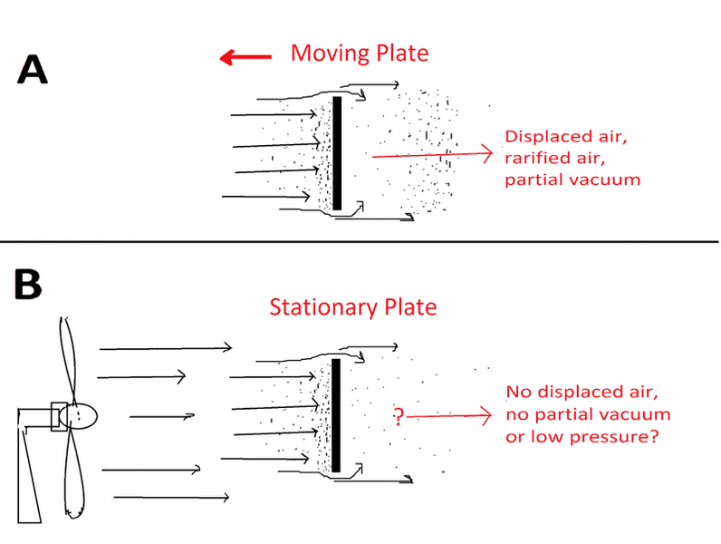

Hi All!
See the picture.
A-Consider a flat plate physically moving perpendicularly through the air.
B-Consider this same flat plate sitting perpendicularly and stationary now in a wind tunnel where air is made to flow.
Accordingly if airspeeds, areas etc are similar, the 2 situations should produce the exact same results.
However, I am interested in comparing only the rear wake drag in the two situations.
In situation A, if I understand correctly, main cause of the rear wake drag comes mostly from the the air being displaced ahead by the moving plate thus creating and leaving a rarified partial vacuum area behind the plate which wants to suck air from top/bottom side of the plate which results in the negative drag pressure i.e. wake drag on the plate.
Now, in situation B, the air coming from the front is similarly hitting the front of the plate and similarly basically not easily allowed to pass behind the plate. BUT!, in situation B there is still ambient air behind the plate, i.e. there is no rarified air or partial vacuum behind the plate because the plate in sitiation B hasnt physically displaced any air mass, right?
I thought perhaps too much about this issue which may have led to this very unintelligent question, still I would love to have clarification.
So, are the wake drags of A and B yet exactly equal? If so, may you explain how the -identical-to-A- wakedrag of B is caused?
Thanks

Just imagine what you would see if you were moving along with the same velocity as the plate. It is exactly the same thing you would see if both you and the plate were stationary in a wind tunnel.
Also, be careful with the term "rarefied". It has a very specific meaning in the context of fluid mechanics and typically denotes a region of fluid where the mean free path is large enough that the continuum assumption breaks down.
Sorry, perhaps the word rarefied was not adequate, what I mainly meant was that the air flow directly behind the moving plate seemed different than behind the stationary plate.
Ok, let's see, I am moving with the moving plate, let's say I am at the center of the plate area and looking now downstream towards the center of the wake. What I see is that the air particles are moving away from me further downstream, where--directly behind the plate- there is a zone of lower pressure created by the plate as it has scooped out the air. In other words, immediately behind the plate and at the center of the wake there are less air particles than far far downstream.I am now sitting at the center of the stationary plate in the windtunnel, The windtunnel is still Off, I look at the space where the wake will be created and I see stationary airparticles at ambient pressure. The fan of the windtunnel starts, those air particles immediately behind the plate at the center of the wake are still
stationary(?), as the plate itself hasn't scooped out any air. And, well, you see, that is where my problem lies.
Attempt at understanding
The only way I can imagine how the air particles in the center of the wake directly behind the stationary plate are affected is by the interaction of escaping airstreams coming from the front and out from the plate side edges. We could see that the viscosity of these edge air streams are affecting the air directly behind the plate. Sure, but this viscosity effect also exist in the moving plate scenario A in addition to the displaced air effect and thus is not an adequate explanation In my humble opinion? Thanks
The two situations are identical. What @Chestermiller was attempting to have you do is imagine the plate moving me through the air. You are looking at it from the side like your picture shows. Now imagine while it moves, you are moving the same rate still looking at it.

I disagree with the description of the moving & stationary plate cases. In both cases, air is being forced from the leading face of the plate off the sides. There is no vacuum formed on the back side, air doesn't jump from the edges to move behind the plate, but swirls form based properties of the air flow at the edges, these are either carried away by the flowing air or stay in place as the plate moves away. The effect looks the same for both moving plate & stationary plate in wind tunnel.
Hi leviterande,
Here's a thought experiment for you.
You're in a tunnel. You're sitting on a cart, and the flat plate is mounted facing forward on a vertical pole affixed to the cart. The cart can move forward with a velocity V, and the ride is so smooth that you can't even feel the cart moving. The walls and floor of the tunnel are so smooth that you can't tell visually whether the cart is moving forward or not. There is a fan ahead of you in the tunnel that is capable of blowing air at a uniform velocity V toward you. The fan is either far enough away or is transparent, so that you can't see it.
Situation 1: The cart is moving forward with velocity V, but the fan is not blowing
Situation 2: The cart is stationary, and the fan is blowing air toward you with velocity V.
In both situations, the velocity of the air relative to the cart is V, and the velocity of the cart relative to the air is V (in the other direction).
I submit that there is no experiment you can do to prove that you are experiencing Situation 1 (and not Situation 2), or vice versa. If you can think of one, please describe it. The air velocities that you measure from your frame of reference on the cart will be exactly the same, the streamlines will be exactly the same, and the pressures at various locations (including behind the plate) will be exactly the same.
Chet

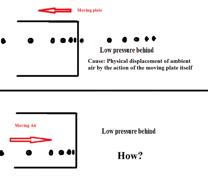

I understand that the situations should be the same but I want to understand how, how the air directly behind is the same for the 2 situations.
To illustrate my point even further look at the picture below, replace the flat plate with a C- shaped plate, i.e. the flat plate now has sides on top and bottom. For simplicity's sake let's assume from now that all flows are 2D.
The moving C plate has a low pressure air behind it as described earlier.
Now, how will this low pressure form behind the stationary plate? The air from the fan of the wind tunnel can barely get around and behind the C plate?
I don't see how you can say that. The air in the stationary C plate picture is also blowing around the outside of the plate, and circles around in back and down.
I would like to see what you think the streamlines look like for the stationary C plate case. Can you please prepare a sketch of what you think the streamlines look like. (I know what they look like, but I'd like to give you a chance to work it out).
Chet

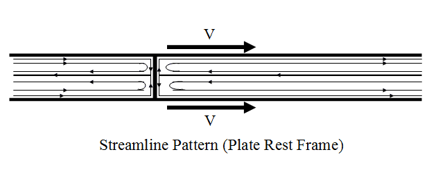

One more item, for a flat plate, the air will not curl around the edges. In both cases the air is forced to move parallel to the plate, once it reaches the edge, it continues in a straight line, due to the change in momentum caused by the flat plate changing the direction of flow. Other shapes (cylinder, square, sphere, etc) will have different flows.
Flat plate moving or stationary with air moving against it will have the same flow patterns, no negative pressure behind it.
Please provide a diagram of what you think the streamline pattern looks like for air blowing past a stationary flat plate (illustrating what you said above).

This is not correct. The tunnel is very long and open at both ends, which is very different from compression of a gas in a cylinder. The flows and deformations are entirely different. Any air that is heated near the plate is swept away (forward) relative to the plate.
Please provide a diagram of what you think the streamline pattern for this situation looks like in the stationary-plate Galilean reference frame.

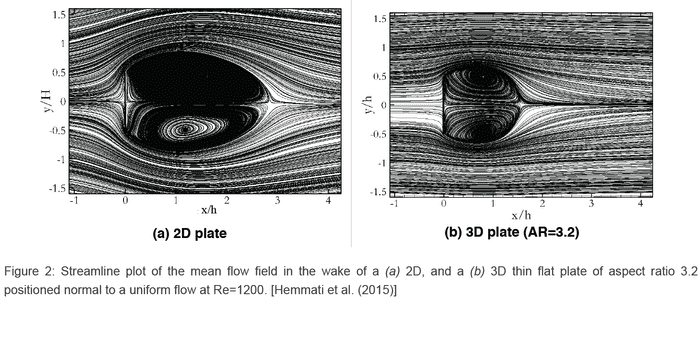

You can keep repeating this as many times as you want, but that doesn't make it true. You can find an incredibly large quantity of evidence refuting this claim if you, for example, do a Google search.
If Google isn't your style, how about a search in the Journal of Fluid Mechanics, which is arguably the most respected journal in the field. (EDIT: It turns out that the link here just goes to the article listing and doesn't actually link to the search. You can do the search yourself by just typing "normal flat plate" into the search field).
Not a fan of JFM? How about a search in Physics of Fluids, arguably the second most respected journal in the field.

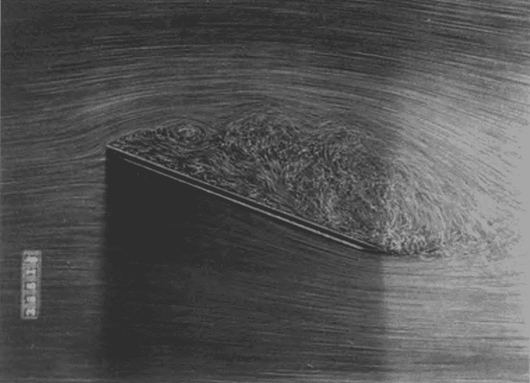

@Vedward cold also do some trivial experiments:

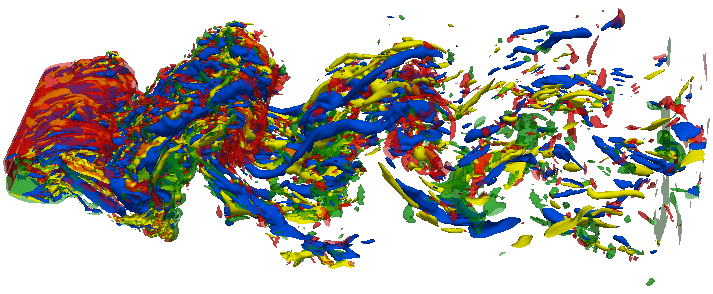

Why do you think the air behind is not affected by the stream coming from the fan? Consider the case of a wind tunnel where you have a free stream passing over the plate. You have correctly pointed out that there will be an region of elevated pressure in front of the plate. However, as the air in front is redirected and moves out over the edge of the plate, the free stream influence will tend to bend it back toward the free stream direction and will tend to drag the air behind the plate along with it. Once this process reaches steady state (in a time-averaged sense), this will tend to set up a pair of recirculating regions behind the plate as shown here:
That is the time-averaged flow, as the actual flow for any realistically large Reynolds number will be unsteady and what you will find is the development of a Kármán vortex sheet behind the plate, which will look something like this:
In each of these cases (time-averaged and time-resolved) the situation is identical to what would happen with a flat plate moving through stationary air.

He is considering a piston fitted in a cylinder there. No free stream at all. See post #21.
  • #32
Ah, I missed that. Still, I think OP likely suggested that situation without realizing that it invalidates the original question since there is no one actually suggesting that those two cases would be identical with a wind tunnel completely blocked like that.
  • #33
Dear boneh3ad, admittedly yes I know that this last example may look very different, but I wanted originally to consider this last example to show the same point I have in mind, namely the wake drag portion behind the plate.
I understand that the air coming from the front and around the plate´s edges affects the air behind, induces vortices, and contributes to drag. I just thought that this edge rushing air from the front is only partly responsible for wake drag or drag on the back side of the plate. Besides this edge rushing air component of wake drag, I thought that there is another additional component of back side drag. I thought that the air mass originating from behind the plate played a roll and also partly responsible for the wake drag.
I feel confused but from what I understand so far from you is that in both of stationary plate or moving plate scenarios, there is only ONE single reason for wake drag or back-of-plate-drag which is: the air rushing from the front over and around the edges?
  • #34
leviterande said:
Dear boneh3ad, admittedly yes I know that this last example may look very different, but I wanted originally to consider this last example to show the same point I have in mind, namely the wake drag portion behind the plate.I understand that the air coming from the front and around the plate´s edges affects the air behind, induces vortices, and contributes to drag. I just thought that this edge rushing air from the front is only partly responsible for wake drag or drag on the back side of the plate. Besides this edge rushing air component of wake drag, I thought that there is another additional component of back side drag. I thought that the air mass originating from behind the plate played a roll and also partly responsible for the wake drag.
No. Not in the case where the plate fills the tunnel.
The stationary plate Galilean version of this situation is where the plate is not moving, but the tunnel walls are sliding backwards. They are dragging air with them. So the flow is a combination of pressure flow and drag flow (drag by the walls). I see no one has realized this Galilean situation yet. Would you like me to draw the streamlines for this flow so that you can understand how the force on the back side of the plate comes about?
  • #35
If you start a plate in motion in stature air until it reaches the same speed as in the wind tunnel case, then it will eventually reach the same state. Any effect of the mass of air behind the plate initially would fade as the air rushes around the edges and the wake develops.
Those vortices that develop will tend to throw any "excess" air out of that region anyway. Since they are rotating, there is a centripetal force involved which is provided by the pressure gradient, meaning the vortices will have low-pressure centers just like in the wind tunnel.
Regarding your example with a plate filling the tunnel, this cannot be used as an analogy. The walls would prevent any flow from going around the plate at all, which is not analogous to the moving plate in stationary air.
