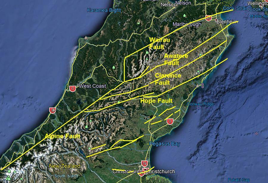

and I see similar possibilities/pattern in the NE corner of the South Island of New Zealand.
The Alpine Fault that runs the length of the South Island, splays into several large faults in the NE of the region.
1) the Wairau Fault - the continuing main trace of the Alpine Fault -no major event in recorded history - 500 years
2) further SE, the Awatere Fault - no major event in recorded history - 500 years
3) further SE, the Clarence Fault - no major event in recorded history - 500 years
4) further SE, the Hope Fault - Major ruptures in 1888 and 2016
Further to the SE is a large number of smaller parallel and at this time disjointed faults including the faults that ruptured
in the 2010 ands 2011 Christchurch damaging events and I do wonder if we are seeing a continuation of the trend of
significant new splay faults being formed in the region that are now the ones that accommodate the majority of the plate
motion.
A basic fault map, I have drawn up, of the region showing the major faults and the lesser ones including the faults that
ruptured in the Christchurch 2010 and 2011 quakes
Dave

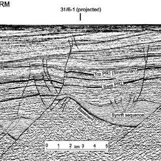

Is there a way to map faults other than by mapping the occurrence of earthquakes?

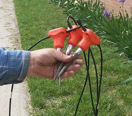

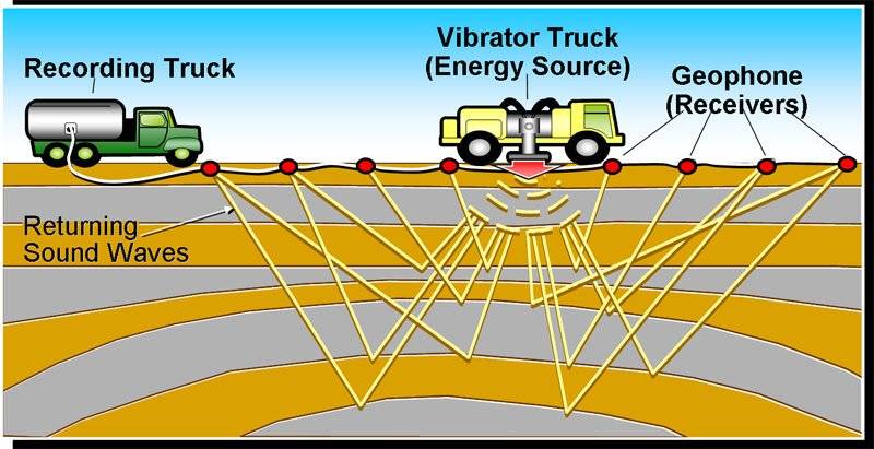

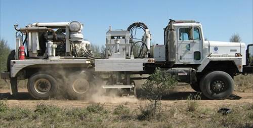

Yes, by seismic surveying. On land they use small explosives or thumper trucks to be able to penetrate
several km into the ground to see underground structure ... layering, faults. The reflected signals that
are picked up by multiple geophones, like the ones I use at home to record local quakes, show depth
to and thickness of the layers.
long strings of geophones like these are laid out...

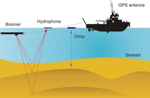

At sea they use boomer units towed behind boats. These units produce bursts of sound ( hence the
name boomer) that goes down through the sea through the sea floor and again like the land system
the reflected sound waves are picked up on the unit being towed by the boat.
I spent a day or 2 on a boat off the local coast back home in NZ as part of my 3rd year uni studies.
I can't find a decent photo of a boomer unit behind a boat so you will have to settle for a drawing

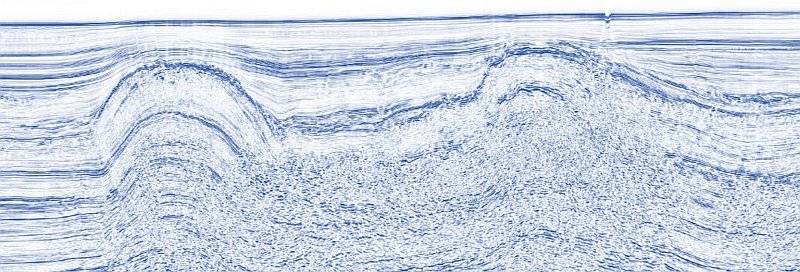

Some surveying results...
a couple of nice anticlines...
layers offset by faulting...
Dave
