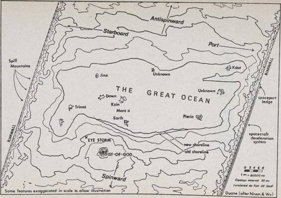

In Ringworld the ring had a diameter of approximately 1 AU and a tad under 1g so here the rotation period is 9 days. Calculating the inhabitable area of that particular ring to be around 3 million Earth surfaces made my head spin back when I first read it.
There are full scale maps of both Earth and Mars as islands in one of the Great Oceans. There are very difficult to spot on a map of the Ringworld. Blink and you'll miss them.
