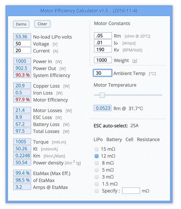

I am closely associated with small personal electric vehicle designers, and I have created some electric vehicle efficiency calculators personally, but I have also used this calculator (which I did not write) which as far as I know is based on equations relevant to the permanent magnet motor found in the tesla 3:
http://www.bavaria-direct.co.za/constants/
Entering some parameters which can be achieved in some of the small do it yourself personal vehicles I am familiar with, we get around 90.3% electrical to mechanical conversion efficiency:
If I am understanding correctly -
1G of gasoline will produce 0.4 x 33.7 kWh = 13.48kWh
and the electric motor will net 0.9 x 13.48 kWh = 12.42 kWh used work in moving a vehicle
1G of gasoline will net 0.25 x 33.7 kWh = 8.425 kWh used work in moving a vehicle
So there is roughly a 47% advantage to using the gas (sic) to generate electricity as opposed to burning it directly in an internal combustion engine.
This isn't really apples to apples, because one burns coal or natural gas or something besides gasoline to generate electricity, but at least it shows that in general, its potentially more efficient to use fossil fuels to generate electricity en-masse and then use that electricity to power vehicles.

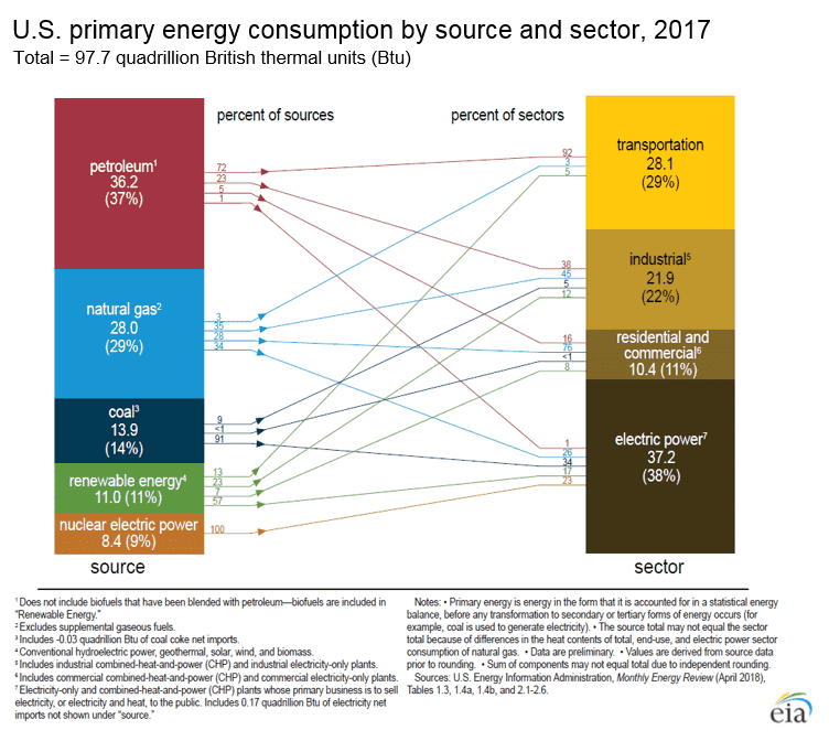

But there's another problem. The power grid may have problems expanding fast enough to meet the demand for electric vehicles. The figure below is from
https://www.eia.gov/energyexplained/?page=us_energy_home
As you can see, to totally shift the transportation sector onto the electric sector means nearly doubling the electric capacity. But some transport such as ships and planes do not switch to EV, so let's say in round numbers 50% more electric power.
That is more than just power plant capacity, but also the transmission lines, distribution, and perhaps even upgrading the electric service entrance to every house and building. That can be done, but not overnight and not at zero cost.
246642
Likes berkeman and Grinkle
