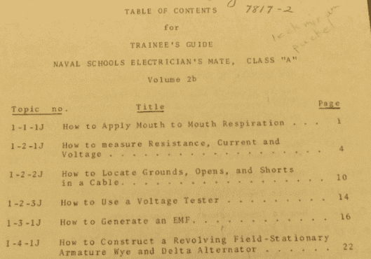

You have brought in a very relevant point. Basically, Technicians are 'Trained' to perform certain functions and the training is aimed at being a cost effective way of producing people who will be able to work the technology. The services want people who can 'do the job' and I don't feel that recipients of many courses get a good deal out of them. Electrons and Photons are brought in in an effort to 'explain' the inexplicable (inexplicable with their levels of knowledge). It just demonstrates how difficult a subject Physics is when many of the educationist fail to understand the limits of the simple models they are using. I assume that, as you had a rigorous electronics education, you appreciate that electrons only need to be considered when you're inside some components. From many of the comments in your posts, I also assume that your previous education, rather than the 'training' in the military accounts for your ability to give 'good' answers.
When I started my education electrons in tubes were still very common so we learned the basic rules of tube operation in a way that was consistent with a physics based model of particles, fields, acceleration and energy.
I think one of the basic misunderstanding in the beginning starts with the idea of electric current (a moving electron) as the electrical KE energy media in a circuit. Any simple educational model or analogy must build a foundation that clearly explains that is a confusing simplification of how the circuit works even in a simple battery and lamp circuit. IMO we need a basic fields based approach from the beginning in circuits as explained in books like this.
