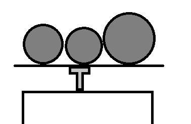

I have 3d printed some 25mm cubes all with the same parameters. what i want to do is take some different weight dumbells, and drop them all from half a meter onto a cube. My goal is to collect data and see at what impact force the cube fails. For me, failure will be when layers break apart, not a total destruction of the part.
since the weights will be falling, it has KE, and we know that at the top, before the fall, PE=KE, meaning, milliseconds before the weight hits the cube, all the PE is now KE. This allows me to find its velocity right before impact. Since i now have its velocity, i can find KE on impact. All the KE will be transferred into the cube. A transfer of energy is work done
ok, so we all know that work done = force(distance) so force =work done/distance.
Here is my issue, i don't know distance. Usually distance is some sort of deformation or if the weight falls on a nail, its the distance the nail is driven into the wood. So i am not sure what to use as my distance?? should i use a value close to 0, but not 0??
i do not have access to a izod or charpy tester, nor do i have the time to make one.
i want to try it out this way and see what happens. Ill plot the data in excel and see what i can find:)

LT72884 said:
I am specifically looking for impact force.
There are several ways to measure impact force.
1) Mount a load cell under the cube, and measure force vs time for the impact. A sample rate of about 10,000 samples per second would be about right depending on the stiffness of the block. It's easy to make a simple load cell if you know how to work with strain gages. The load cell will need its natural frequency to be at least 10 times higher than the duration of impact.
2) Use high speed video to observe the impact. You will need a frame rate at least 1000 frames per second, and possibly faster depending on the hardness of the block. (A) Measure position vs time, and calculate peak acceleration, and calculate the peak force from the mass and peak acceleration. Or (B), assume a constant spring constant (not a good assumption with elastomers), measure the peak deflection, calculate the spring constant from ##KE = 0.5kx^2##, and calculate the peak impact force from ##F = kx##, where ##x## is the peak deflection.

I have done a very similar experiment simulating a vehicle crash using an air track. I use a cone made of soft clay to take the impact. I actually make two identical cones, then subject one to the impact and the second to a static force which I adjust to give the same deformation. The impact deceleration can be found from the stopping distance, then we apply Pt=mv to find the force. We then compare this with the deformation of a second cone with a static load.

well, here is what i think. for a free falling object, such as a metal dumbbell, F=MA. We also know that V=GT and since we know V and T then G works out to be 9.8, so all i need to do is take the mass of my metal dumbbell and multiply it by G and i will have the force, or in other words the weight of the object because MA is the same as the weight of a free falling body and now I am lost hahaha
working in english units for a moment. If i drop a 10 Lb metal block onto a cube, and it doesn't break. I know it can handle 10Lbs of force, but that's incorrect thinking because having 10Lbs just rest on me is not the same as having 10Lbs fall on me
Likes jbriggs444
Correctly observed. The force required to support an object at rest is not the same as the force required to stop it in an impact. Not even close.
Perhaps "force" is not the parameter of interest for an impact. Perhaps neither "peak force" nor "average force" are the right parameters either.
