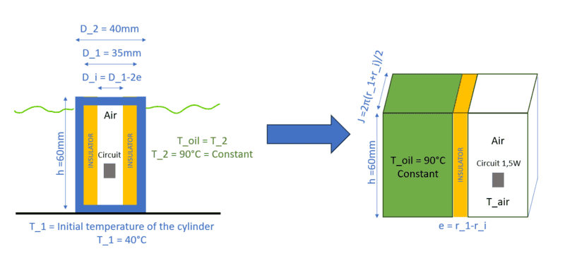

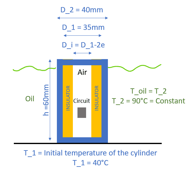

Does it look like this?
Then, you want to find how the air temperature inside the barrel (material unknown) changes with time depending on how much insulation (material unknown, initial estimate is aerogel) you put in. Is that it?
How much power does the circuit generate by the way?
Hi Juanda,
This diagram represents the situation well, thank you very much for your involvement, it would have been up to me to do it in my first post.
Yes, that's it.
I don't know what material or combination of materials I'm going to use.
Perhaps the outer material (in blue) will be aluminum, to limit radiant heating, and the inner material an insulator. But for the calculation I'm only considering the insulation, aerogel in this case.

All right. If the problem were stationary it would be much easier but you're interested in how it evolves with time.
I'll try to solve it using MANY simplifications.
  1. The relevant heat exchange only happens with the walls of the cylinder. Ground and top could be considered but they only make the problem more tedious and I'm just trying to post an example of how I would approach a problem like this.
  2. Heat flux in cylinders has a different equation than the one you showed because as the radius increases, the surface area increases too. However, since the inner and outer radii are pretty similar, I think it's OK to use the heat flux equation for "flat surfaces".
    $$\dot{Q}_{in}=k \frac{dT}{dx}$$
  3. I will consider the temperature distribution in the cylinder to be linear. This will be definitely not the case but the problem is quite harder if we don't take that. As a first shot, it should still provide some numbers to get an idea of how the system will behave. If the temperature in the cylinder is linear then
    $$\dot{Q}_{in}=k \frac{dT}{dx}=k \frac{\Delta T}{\Delta x}$$
  4. Only the insulation layer will be studied. I feel like the aluminum will get as hot as the oil pretty quickly anyways so I'll skip it. The problem could be solved considering the aluminum too but it'd require adding an annoying intermediate point.
  5. The insulator in contact with the oil (assuming aluminum walls don't exist) will have the same temperature. The insulator in contact with the air inside will share the same temperature as well.
  6. I'll assume the mass of air in the cylinder is constant and has a uniform temperature distribution.
  7. I'll ignore the mass of the circuit because nothing was mentioned about it. I'll simply assume the temperature of the circuit is the same as the air surrounding it.
So the simplification looks like this.
The surface for the heat to travel is
$$S = Jh = 2 \pi \frac{r_1+r_i}{2}h$$
The change in energy for the mass of air will be a combination of the heat input from the oil and the heat generated in the circuit.
$$\frac{dU}{dT}=\dot{Q}_{in}+\dot{Q}_g$$
If we treat the air as an ideal gas, its internal energy will be a function of its temperature.
$$U=mC_vT_{air} \rightarrow \frac{dU}{dT}= mC_v \frac{dT}{dt}$$
The mass of air can be found with the volume inside the cylinder and the atmospheric conditions before warming it.
$$m_{air} = \rho V = \rho \pi r_i^2h$$
The input heat will be.
$$\dot{Q}_{in} = kS\frac{T_{oil}-T_{air}}{r_1-r_i}$$
The heat generated has been declared as
$$ \dot{Q}_{g} = 1.5W$$
Finally, it is possible to solve the differential equation. (T is the temperature of the air in the container)
$$mC_v \frac{dT}{dt}=kS\frac{T_{oil}-T}{r_1-r_i}+1.5$$
Be careful with the units! I wrote 1.5 because I'd use the international system.

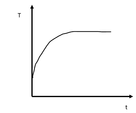

I cannot solve it now but the solution should look like this.
Where the stabilization temperature will actually be slightly higher than the oil temperature due to the circuit generating heat. Basically, the oil will end up refrigerating the air inside.
There are a gazillion simplifications I had to do to solve the problem but heat transfer problems are pretty hard. Especially if they involve changes in time. Hopefully, this approach will be realistic enough for the situation you're facing.
