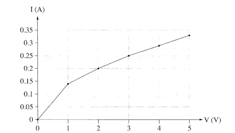

This graph was given, which describes the current through a resistor, as a function of the voltage.
Then, we were supposed to find the resistance of the resistor when 3V<V<5V.
But it changes throughout this range, doesn't it? Because in the answers (Mind you, this is the FINAL physics exam in the country), it says we were supposed to do: R=ΔV/ΔI, which I believe isn't correct when the line doesn't go through (0,0).
What do you think?

The formula ##R = \Delta V / \Delta I## is correct; just because the tangent line of the graph does not pass through the origin is no reason to reject it. When resistance varies with voltage (or current), the equation ##V = IR## is no longer true.

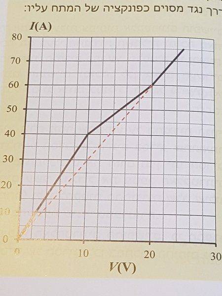

I thought that the definition of resistance is literally V/I, what makes it incorrect to use here?
And also my book says the opposite. Here is an example (it's in Hebrew but look at the numbers, it says the resistance varies in the second part). Is the book really straight up wrong?

No, it does not make a lot of sense, but that is likely due to making a crude, piecewise-linear approximation to a curved graph. For a smooth curve ##I = f(V)## the "local" resistance at ##(V_0,I_0)## is ##R = 1/(df /dV)|_{V = V_0}##, and that will typically depend continously on ##V_0##. It will be the same resistance for small increases or small decreases of voltage near the base value ##V_0##.
In your exam's case, the resistance at some voltages is a bit different for increases than for decreases, but as long as you specify the value of ##\Delta V## the answer will be unique.
I don't read Hewbrew, so I cannot say. However, the link I included tells you the actual situation as it applies to non-ohmic cirduits.

I can tell you what is says. It says that throughout the second part, the resistance starts at 0.25Ω and ends at 0.3333Ω, and that in this part 0.25Ω≤R≤0.333Ω, which would be nothing but straight up wrong, I believe, according to what you say. I just find it odd.
The resistance actually can vary over voltage and it's definition is indeed ##\mathrm{d}V/\mathrm{d}I##. If you get the graph of V against I of a non-ohmic component like let's say, a lamp, you can see the graph behaving as a curve instead of a straight line, and at each point of the curve you have a different slope, therefore a different resistance.

It's the definition of Ohm's law, not resistance. It's only a way to determine the resistance of a resistor that obey Ohm's law.
Right: it tells you something that seems wrong. Between V = 3 v and V = 5 v, the graph looks very much like a straight line, going from about I = 0.25 A at V = 3 v to about I = 0.33 A at V = 5 v, so a change of about 0.08 A in over a voltage change of 2 v; that gives a resistance ##R = 2/0.08 = 25 \, \Omega## over the whole range.
I looked this up on Wiki, and they call V/I the chordal resistance while dV/dI is called the differential resistance. Ethan, I thought that your approach to getting the resistance was totally valid, and in agreement with my experience. But Ray has lots of experience, and his expertise needs to be respected. Is it possible that the exact statement of your problem asked for the differential resistance? What was the exact wording of your problem.

I am so confused right now. It literally said "calculate the resistance", nothing more.
Sorry. If that's what it said, then the question is poorly worded (unless they specifically defined resistance in your course as dV/dI).

Your confusion is not your fault. It is their fault. You have a legitimate complaint.
I'd have thought common sense had a part to play here.
On such a V - I curve, how can you have a single ## R = \frac {V} {I} ## resistance, or an ## R = \frac {dV} {dI} ## resistance, over a range of voltages ?
The only resistance that makes any sense to me here, is the incremental resistance ## R = \frac {ΔV} {ΔI} ##
Though I agree the question should be better expressed.
Likes Felipe Lincoln
Yeah... We can also think of ## R=V/I## as ##R=\mathrm{d}V/\mathrm{d}I## passing through origin, it's exactly the same thing. So in ohmic devices we use ## R=V/I## just to evidence the fact that in this case it will pass through (0,0)

The resistance at a voltage V is not the slope of the IV curve at V. It's the slope of a line from the origin (0,0) to the point V on the curve.
In this case the resistance varies over the range 3-5V. As far as I can see the problem statement doesn't imply a one value answer.

So this is a standard exam that every student in your country takes? (e.g. for exit from high school or for a standardized university introductory physics course)
If yes, then there must be a standard curriculum that your instructor/professor is supposed to follow, which defines resistance as:
If your instructor did not do that, then your problem is with the instructor. If he mentioned R = V/I, he should have discussed the considerations that were mentioned in this thread, and made clear which definition you should expect to use on the exam.
  • #31
Eitan Levy said:
In the answers only one answer was given.
In which case I'd want to see the exact wording of the question. At the very least it's unclear in the OP.
You could try writing to the examining board but most won't enter into correspondence. I'd be tempted to find a forum for professional electrical/electronic engineers in your country and post the question there. Dont post the answer initially, just see what replies you get. Perhaps see if you can't interest them in writing to the board to complain about the quality of the question.
Here in the UK the correct answer for this in a GCSE Plysics exam (taken at age 16) would be the range of values given by R=V/I.
Likes Merlin3189 and Chestermiller
