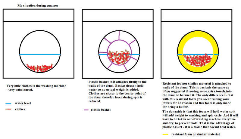

During summer i wash light items - t-shirts, boxer shorts and low-cut socks, washing machine is just 1/4 full and it cant balance during spin properly. During winter with bigger items there is no such problem.
So i was wondering, could a temporary solution be to just use some kind of basket inside the washing machine that would artificialy make its drum smaller and therefor all clothes would be closer to center of the drum therefor reduce centripetal force ? Can such thing be bought ? Would it even work the way i imagine ? See attached images for more details.
We ignore washing efficiency for now, let's just talk about forces during spin cycle.
Centripetal force would be bigger.
It can be done, as long as there is a path for water to drain out to the periphery.

Resistant foam might not be the worst idea come to think of it. If i made it so that it is the exact right dimension to fill the inner walls of the drum and if it was in one piece, it will be like a very big washing bag. But it will be big enough to hold the walls of the drum and not slip. Foam will absorb water but that is good. Because i will have high mass evenly spread around the walls of the drum. That means that even if light t-shirts and shorts wont be perfectly balanced, their net effect will be lower because bigger mass will be evenly spread.
Im gonna do a test and record it. For science's sake. I dont know why there isnt such a product. For instance, i saw a very neat product for washing shoes in washing machine. Its basicaly a non movable tray to put the shoes on. Well, its strange that they didnt make something similar, like plastic cage instead of plastic tray, that you put into washing machine and its removable. And it would essentialy simulate like you have a smaller drum1.JPGcsm_030171QL8jGMaOpEvW_996b6d9cfb.jpg
What about affixing dense, non-absorbent weights (metal) around the drum so that the weight of your clothes is insignificant in comparison? That's assuming you can attach something to the drum without too much trouble.
... Huh. I've only really ever used vertical drum washing machines except at the laundromat. sure, a bunch of towels or something will throw a vertical off enough to make some noise, but I don't know if there's really any "easy" fix for a horizontal drum. It's a matter of how the load settles as it spins up, and there's very little you can do to control that with modifications to the drum.
The problem I see is that they designed the drum's dimensions and speeds to produce the right amount of Gs to pull the water out. Making an insert to reduce that diameter is going to cut into that performance and will leave your clothes wetter when the cycle finishes.

...some kind of basket inside the washing machine that would artificialy make its drum smaller and therefor all clothes would be closer to center of the drum therefor reduce centripetal force ?
A lot will depend on the exact machine (since on newer machines balancing is done by tumbling the load a few times left and right to distribute the pieces: and at the beginning of the cycle the load is measured some similar way, so the water level could be adjusted as 'just enough' - these kind of tricks will be most certainly messed up well), but by my suspicion reducing the depth of the drum instead of its radius might work better.

If you want the machine actually to wash clothes as well as possible, you need a large diameter drum and an unimpeded path to allow clothes to be lifted up and to fall down continuously. So, unless you want to unload wet clothes and then re-load them, you mustn't have your suggested internal frame.
And there is another way, which some machines use. Better machines even recognise dangerous vibrations, stop, to allow re-arrangement of the load and re-start the spinning process.

Ty for your reply ! Yes. That was the idea behind resistant foam i mentioned (some people failed to notice resistant, which can also mean foam covered in resistant material). Only difference is that foam will lose its weight after the spin cycle starts. Also weights would take a lot less space. That is where foam would be better - reducing the volume of the drum. But weight itself is probably more important. Attaching would be no problem. And it would have to be such that it can be removed when during summer i wash heavy loads, like once a month. Its a nice idea.
Talking about front loading machine, right ? If i understand that correctly reducing the depth could potentialy improve the situation by forcing the machine to balance the clothes easier since there is less space to fill ? Or would the fact that clothes are closer to the point where force is applied to the drum help also ?

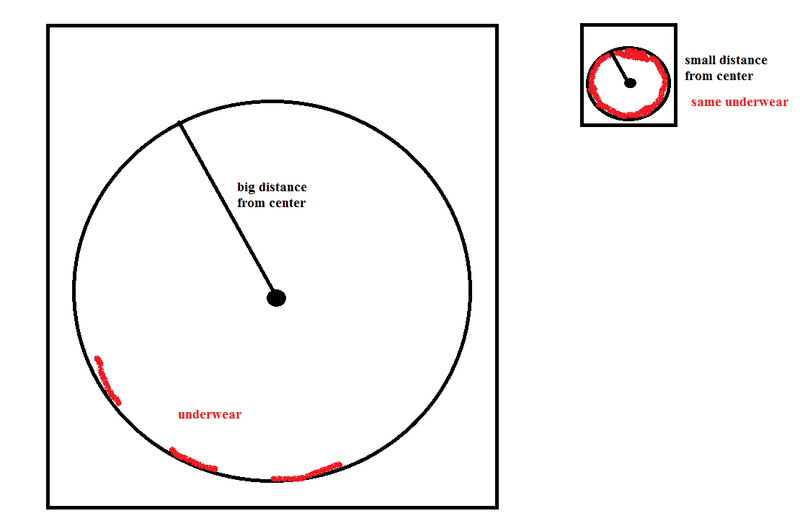

I agree that more underwear is always better. But to stay on topic, i humbly disagree about the balancing and please correct me if i am wrong.
Let's take 2 hypothetical scenarios. We have 3 pieces of underwear (hypotethical). And we have a washing machine with a tiny drum, maybe something dwarfs would use. If we stretch those 3 pieces of underwear along the wall of the drum, they cover it completely and we have a balanced load. Now lets take another extreme (hypotethical). We have a huge washing machine, something that giants would use. It would be very hard to balance the load with only 3 pieces of underwear since they would need to be spread at exactly same distance from eachother. And also, even if the tiny drum was unbalanced, it probably wouldnt make much difference. But the big drum would spin very violently due to distance of wet underwear from the center. As far as physics goes, is that correct ?
SentinelAeon said:
. But the big drum would spin very violently.
Only if the load were more than the system is designed for. Also, the tiny drum would need to spin faster by the square of the ratio of radii. And a small drum would be useless for tumble washing, which relies on dropping the clothes repeatedly by nearly the diameter of the drum. A very full washing machine washes very badly.

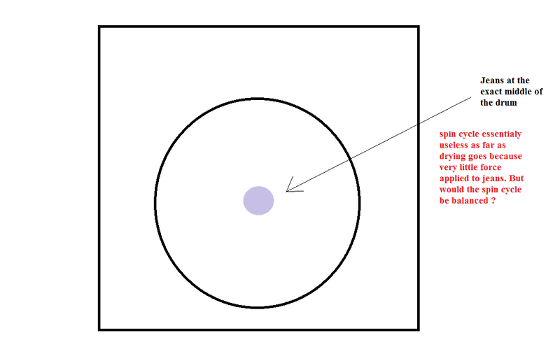

Exactly. Thank you ! So now lets take this problem that the internet is full of - a gal needs to wash just 1 pair of jeans and has nothing else to put into the drum. Obviously if she puts only the jeans in the result will be bad. If its a new machine, it will refuse to spin. If its an old machine, it will do the harlem dance. And there will be some washing machines that will wash nicely but i dont have even the slightest interest in those.
Now. Let us say we would have some way to keep the jeans to the exact center of the drum. And the water would be high enough to reach them. And the gal also had some other means to dry the jeans afterwards with a click of a button so it wouldnt matter that the jeans were still soaking wet after the spin. And also the jeans were only sweaty so there wouldn't need to be much movement in a drum to get them nice and clean. So here it goes. Would the fact that those jeans are at the exact middle of the drum, mean that drum would spin nicely because the load would practicaly be balanced already - balanced at the exact center of the drum?
Yup.
A minor detail though is that there won't be much water removed from the jeans because they are not subject to any centrifugal force.

Yes. If you have - example! - 25cm deep drum those few socks 'n stuff will be just lie on the bottom, far from the axle: with reducing the drum to 15cm depth, they will start to fill up the remaining space and will be closer to the expected 'full' state.
