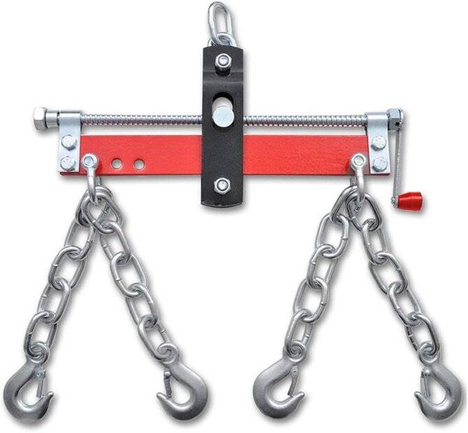

IIRC, similar issues with garage / work-shop 'engine' hoists are addressed using a side-shift 'leveller' beam.
Likes sophiecentaur, Lnewqban and berkeman
