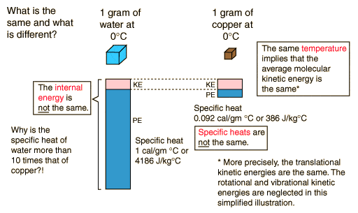

I was looking at this page and it explains the heat capacity difference between copper and water in terms of a difference in potential energy change as the molecules are heated.
What does that mean? I know water has polar bonding so is it due to the water molecules having much stronger attractions which must be weakened by the heating?

It's quite obviously wrong, so it doesn't really matter what they mean at that page.
One thing that matters regarding specific heat capacities of copper and water is that one gram of copper has different number of molecules compared to one gram of water.
I think you may be referring to the Dulong Petit law, which was an early law about the thermal behaviour of crystals.

Somehow I just guess that if we want two materials with very different specific heats, then hydrogen and uranium are good choices.
Wikipedia tells us the specific heat of hydrogen gas is 123 times the specific heat of solid uranium.
There's no huge amounts of potential energy in hydrogen gas that could explain the huge specific heat. (that was the wrong explanation at the page)

Wrong type of heat capacity explained with an explanation that is wrong.
Text books explain that the heat capacity per mole is different in different materials, because molecules have different number of degrees of freedom ... or something like that.

IMHO hyperphysics page explanation is perfectly correct, what is incorrect is overgeneralization and trying to apply the same logic to every other case.

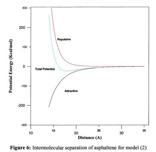

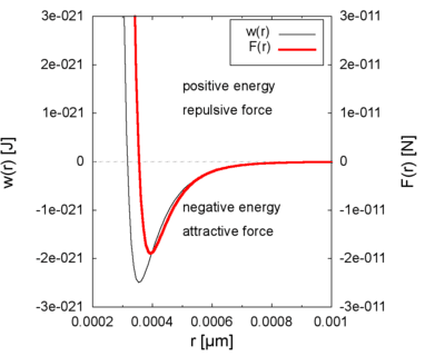

Trying to find the answer myself, I watched a video, where a gentleman presented a graph showing "intermolecular potential energy".
Something similar to this:
Which still left me a bit bewildered, so I googled some more and ran across a paper by some Iranian gentlemen studying something called asphaltene. They had many similar graphs, including this one:
Which kind of told me why the first graph, from right to left, curves down, and then up.
The x-axis in both graphs represents the distance between the molecules.
