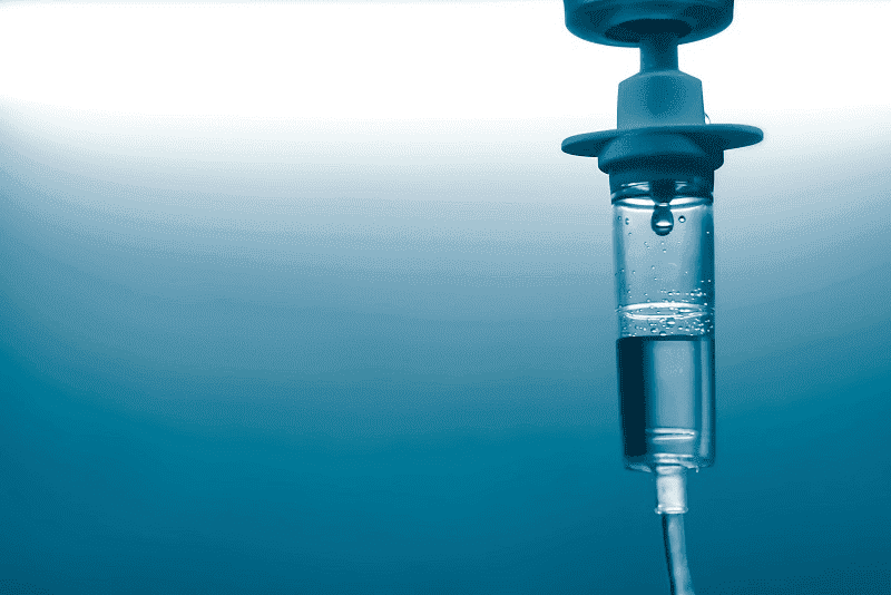

I have not seen that with IV administration. The drop size depends on the IV tubing size (macrodrip or microdrip), but not on the flow rate (in drops per minute). What size tubing are you using, and how are you controlling the flow?
https://www.mometrix.com/academy/calculations-of-drip-rates/
https://www.recoveringself.com/health/iv-drip-therapy-the-science-behind-the-fad

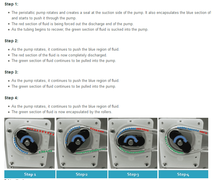

And if you want to control/meter a flow, a peristaltic pump is a good option usually. We use them all the time in medical applications (like IV infusions)...
https://www.graylineinc.com/whitepapers/peristaltic-pump-tubing.html

The only way to get numbers for a fluid with unknown characteristics is to run a bunch of experiments. Even in hospitals, the Intravenous Drips are controlled by a constriction upstream of the drip chamber, effectively controlling the pressure to regulate the flow.

Did you look into peristaltic pumps at all? 150cc/hr is certainly do-able with high accuracy...
I am not here looking to purchase an item. I am here to determine the drip tube diameter required for my specs. It will be connected to an IV bag and then some other means of regulation will control the flow.
