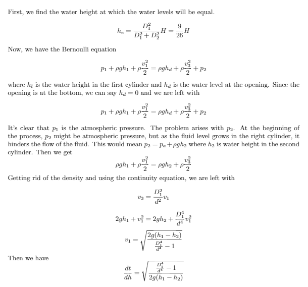

In summary, the problem statement is: Given two cylinders, with a hole in the side at the bottom, find out how long it takes for the water levels in the two cylinders to equalize. The given/known data is that the first cylinder has a diameter of D1=3 m and the second cylinder has a diameter of D2=4 m. The hole diameter is d=10 cm. If the first cylinder is filled with water to the height of H=5m, and the other one is empty, find the time it takes for the water levels to equalize.
Tellerath
1. The problem statement, all variables, and given/known data
Two vertical cylinders rest on a flat surface, next to each other. Both have a hole on the side at the bottom so that the water can flow from one cylinder to the other without leakage. The diameter of the first cylinder is D1=3 m, the second D2 = 4 m, and the hole diameter is d=10 cm.
If the first cylinder is filled with water to the height of H=5m, and the other one is empty, find the time τ it takes for water levels to equalize.
Continuity equation: Sv = const
Bernoulli equation:
First, I determined the "equalized" height as follows:
(total volume) = (volume in the first cylinder after equalization) x (volume in the second cylinder after equalization)
Which gives:
D12H = D12he + D22he
So from here we get
he = 9H/25
This seemed like a simple problem but ended up being quite challenging (at least to me). First, let v1, v3 and v2 be speeds of water (at any moment) in the first cylinder, through the opening, and in the second cylinder respectively.
(sorry for writing like this, but I was already comfortable with latex, so it seemed a faster approach )
I was very tempted to integrate here, but the problem is - h1 and h2 do not change in the same manner.
I cannot seem to be able to get past here.
Probably a typo, but you give two different expressions for the equilibrium height. One has 26 in the denominator and the other 25.
More importantly, your final expression has three variables, h, h1 and h2. There should be only one, say h representing the height in the cylinder that was empty originally. Since the volume of the liquid is fixed, you can express the height of the liquid in the other cylinder as a function of h. Then get an expression for ##\frac{dt}{dh}##.
