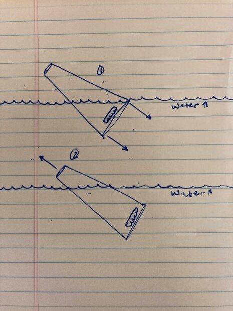

Will water flowing through a funnel be accelerated more by a "curve-walled" funnel rather than a "straight-walled" funnel?

This is for a project I am working on, not related to school work. So far I have been looking for the optimal funnel to maximize volume and acceleration. I have determined that a "narrower/tall" funnel is better for my purposes that a "wide/short" funnel. I've done this just by playing around with various funnels at the hardware store, nothing super scientific. I just couldn't help but imagine that there has to be some optimal curve, similar to the brachistochrone curve. I have read a few papers discussing flow dynamics of funnels of various angles, but not quite what I am looking for. I can't help but wonder if a simple parabola with a spout would suffice?

While I understand the OP question more or less a curvy funnel is a much broader class of objects and so the answer tis almost certainly yes, curvy is better as I think is evident.
But the details are nontrivial and will depend upon a host of factors. For instance how big is the funnel ? Expected flow rates.? Differential pressure?

While I wish that I could give you that information, I just don't have it. What made me start thinking about this is a pool toy I saw the other day that is essentially a cone with two handles on the wide end. The wide end is to be submerged and quickly pulled, resulting in a high pressure jet of water being shot out of the narrow end (photo attached). The toy is probably 8" wide at the bottom and 1.5" wide at the top, over a span of 18". Those toys all have straight sides as depicted. I had imagined that a "curvy" funnel would be better, just didn't know if there was an ideal shape.
Thanks for the description. That looks like an interesting toy. Does the water come out in a relatively collimated jet? I'm sure that turbulent flow is the enemy here. But it may be very subtle. I may cut up some "larger" plastic bottles and hit the pool !
It seems like you might try to optimize in such a way that for any fixed nozzle diameter, minimize the time to drain a given volume?
The aim is to avoid sudden changes in flow direction, which can lead to a "vena contracta" that will reduce the effective diameter of the funnel.

Potential energy must be smoothly converted to kinetic energy as the fluid falls through the funnel. Cross-section must change by the same ratio per unit travel along the funnel.
I believe the optimum flow will be with an exponential horn, like a reversed loud hailer, so the fluid is accelerating smoothly along the channel, without sudden changes in fluid wall pressure.

Here is a short video demonstrating what I am talking about.
I just took a video and am trying to figure out how to post it, but it does look to be relatively collimated. I am a biologist so not super versed with the vocabulary, but it appears smooth/laminar.
