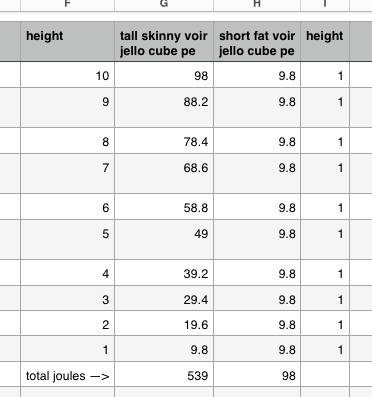

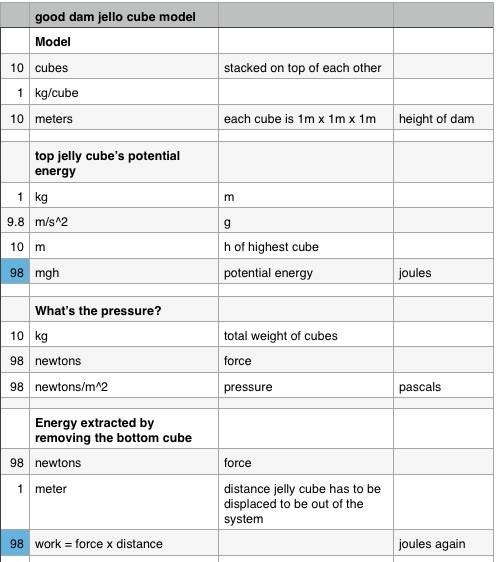

I just ran a jelly-cube bowling ball simulation, and all I could come up with was: If energy is conserved, then there is no difference.

Textbook wise, there is no difference. Realistically though...
Imagine the device you would have to construct to capture all of the energy of a jello cube dropped from 10 meters. It makes my head spin.

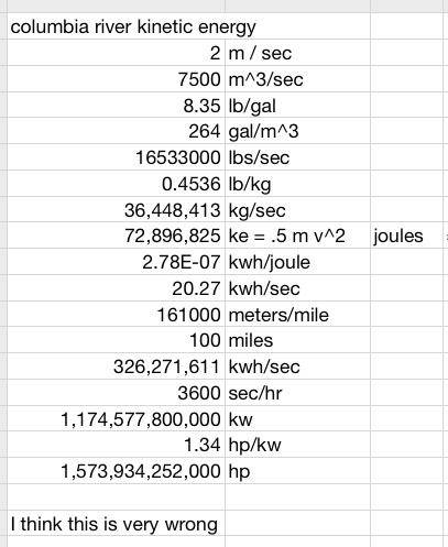

On a somewhat related topic, a couple of years back I decided that it would be a great idea to harness the kinetic energy of the river that flows by my house. Unfortunately, I think I made a math error somewhere:
:redface:
I suppose this is why I wouldn't make a good "real" crackpot. I do the math.

Back to my jelly cube model:
There is mathematically more energy in the tall reservoir vs the short reservoir.
Imagine a stick. If you stand it upright, the top of the stick has lots of potential energy. The bits on the way to the ground have proportionally less energy.
Now imagine the stick laying on the ground. Same stick. Zero potential energy.
When are you finally going to do away with those feet/pounds/miles etc?
7500 m^3/sec multiplied with the density of water gives 7.5 * 10^6 kg/sec of mass flow.
Your answer is somehow nearly 5 times higher.
You can just multiply the mass flow with the kinetic energy for each kg of water (2J/kg)
to get a power of 15 MW of power. I have no idea what the rest of the calculation is supposed to do. If you want another hydroelectric station, you need at least 20 cm of altitude difference between the two to get the speed of the water up to 2 m/s again.
