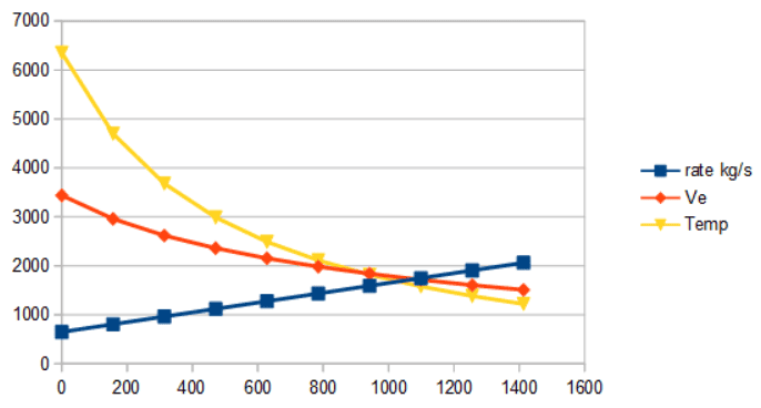

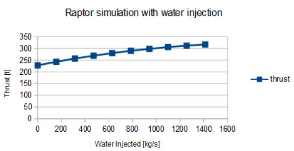

I did some quick calculations, assuming 650 kg/s of MO is supplemented with H20 up to 1400 kg/s
Looks like 40% of thrust is possible with 2:1 water to MO ratio.
Unlikely such a gain is possible without Raptor redesign given 3 times mass flow increase.
What does that mean? Only 40%, or a 40% boost?
Your first graph does not show the reference thrust, with fuel instead of water.
Your second graph has no units on the axes.
Numbers without units are meaningless.
What is Ve ?
The x axis goes to 0, i.e. no water. Using that as reference OP calculated 40% higher thrust values when dumping a lot of water into the engine.
Propellant flow in kg/s as given, v_e is the exhaust velocity in m/s. Not sure about the temperature. Fahrenheit in the combustion chamber would make the no water temperature plausible, but why would you use that unit?
Temperature is in K. I found 5000 estimate, but used slightly different numbers to get me 230t thrust to match initial Raptor spec.
propellant rate [kg/s], Ve [m/s], Temp [K]
