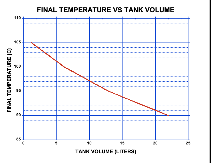

I disagree with much of this. The presence of air doesn't matter since the air/water vapor mixture can be treated as an ideal gas mixture and so the two components can be treated separately. The partial pressure of the water vapor is going to be equal to the equilibrium vapor pressure, independent of the partial pressure of the air. If air is present, the total final pressure will differ significantly from 1 bar because the air has been heated at essentially constant volume from 25 C to the final temperature. The final total pressure will be at least 2 bars.
I have done detailed calculations to determine the final temperature of the gas as a function of the tank volume using the steam tables. I am very confident in the results, but if you would like to see the details, I will gladly provide them.
Here are the results:
So, as you can see, there is a strong relationship between the final temperature and the tank volume. Making the tank volume larger just allows more water vapor to evaporate, which results in a lower final temperature (and final pressure of both the air and water vapor).
Likes collinsmark and ValeForce46
