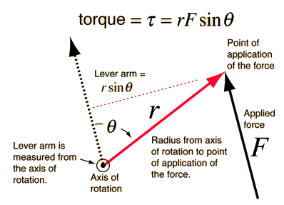

τ=rFsinθ
Lever arm = rsinθ

About the lever arm: What is r in the formula? What is the lever arm if the axis goes through point P at the bottom of the dam?

So you have torque = length of lever arm times force times the sine of the angle between them. That's good. But there is some simplification that you can do. This is part of what Haruspex is trying to get at. Your formula for dτ contains a factor of L sin θ. There is a [much!] easier expression for L sin θ in terms of y.
Alternately you can arrive at the same simplification another way. Instead of taking torque as force times moment arm times the sine of the angle between them, you can view torque as force times the component of the moment arm at right angles to the force.

No, the lever arm or moment arm contains that sin(angle) already. The lever arm is perpendicular to the force.
http://hyperphysics.phy-astr.gsu.edu/hbase/torq2.html
