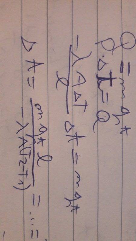

Besides the fact that water will cool down unequaly and circulate while cooling down in the bowl, making it cool down faster, no.
Could any of these equations help? We used them with another problem, melting ice.
