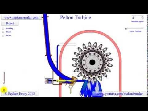

When the kinetic energy begins to dominate over potential energy, the optimum design shape of a turbine changes. The Pelton Wheel shape is used when kinetic energy is very high. Here are some pictures of Pelton turbines.
http://www.absak.com/catalog/images/HP-WHEEL.jpg
