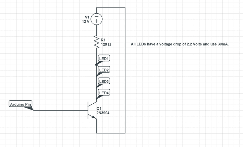

Okay led me try to understand the transistor part. Let's say I use a NPN transistor. The base would be an Arduino pin. The collector would be the 12 volt supply. The emitter would be going to the LED's(with a resistor of course). If I understand this right, triggering the pin with the transistor on the Arduino will allow the 12volts to pass through the transistor with no power/amperage loss? Would this resistor be okay: https://www.futurlec.com/Transistors/2N6043pr.shtml ?

In the link, with an NPN, you keep the Emitter and Arduino close to 0V (GND) .
12+
Current Limiting Resistor
LEDs
Transistor
GND
  • #32
12+
LEDs
Transistor
GND
So I want my wire that is at the end of the LEDs to go into the Collector part of the Transistor. Base to the Arduino, and the Emitter to Negative?
Virtual Example(Drawings of circuits really help me):
Is this how it is supposed to work? The arduino just completes the circuit, correct?
  • #33
HAP...Thank you for taking a few minutes to review ( so many people that come here for answers -- well just want answers!) Yes your sketch is what we need as a concept. -- I have not done the math...
As a good practice the 12V and the arduino should share the same GND or Negative Bus - in this schema these details are not shown...
  • #34
OK back - from my sketch pad... 4 x 2.2 V + 0.2V ( transistor) = 9V... 12 V supply... the difference is ? ... 3 V ... series ckt is 30 mA ..
3 V and 30 mA --- what is the necessary resitance to drop that V?...
Then use the I^2 * R or V*I to get W, and that is the resistance and size (wattage) of the resistor you are looking for... now repeat for the other colors...
  • #35
Thanks for this. And yes, I am looking to learn how to do this on my own, instead of coming here every time I need an answer to something.
So when you were calculating the transistor, you used: (Vf * ledcount) + 0.2V = 9V
What exactly is this meaning? Why do you add the 0.2V?
So then when there is 3V and 30 mA left over, you add a resistor just to drop the voltage to completely 0? (3*30 = 90) This would mean I would put a 100Ω(Closest to 90 rounding up) to the negative then to ground or negative?
Note: Power source in diagram is meant to be DC, not AC
