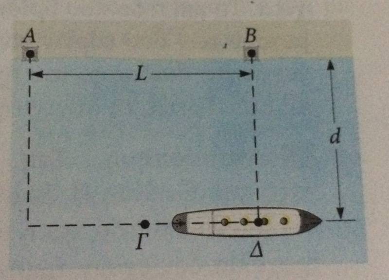

A ship floats across the coat, at a distance d = 600 m from it. The radio of the ship receives simultaneously signals of the same frequency from RadioTowers A & B, which are L = 800 m apart. At Point G (Γ), the two waves confluent in a strengthening way, where G's (Γ) distances from A & B are the same (rA = rB). At point D (Δ), which is right across B, the signal reaches its First Minimum. Find the wavelength λ.
ka6KgpQ9eAAHkmPAk5i5PsIbNEOsu4uIDlaX7SkcWDOEH2IbHavkMSaHRSdLijzR911Kol8-c-T8qPg&owa=outlook.live.jpg
Δr = n*λ , n = 0,1,2,3... (Strengthening-A'=2)
Δr = n*(λ/2), n = 1,3,5... (Weakening-A'=0)
When the book says "First Minimum arrives at..." in every case it means Δr = n*λ/2 with n = 1. So i went ahead and found rA & rB for Δ through the forming triangles, put them in the above formula and got λ = 140 m. Which is wrong. I kinda figured that since I didn't use the stuff for Γ, but anyway. I turned back and saw that the answer was λ = 800 m. Which is a pretty big number.
So I thoughout of it this way: The signals arrive at Γ, the composite wave starts the way a y = Asin(...) wave would (no Initial Phase so it goes from "zero" to +A and then back down) and at Δ it's where the composite wave reaches the "horizontal axis" again, ie it covers λ/2 in length. Through that and the info about Γ (used the rs to find ΑΓ = ΓΒ = 400 m) I did λ/2 = 400 m <=> λ = 800 m
Now the result is correct, but I have no idea if the whole thing has any logic behind it. I was just trying stuff until I got the correct result. I mean, in every exercise thus far "First Minimum" just means Δr = λ/2.

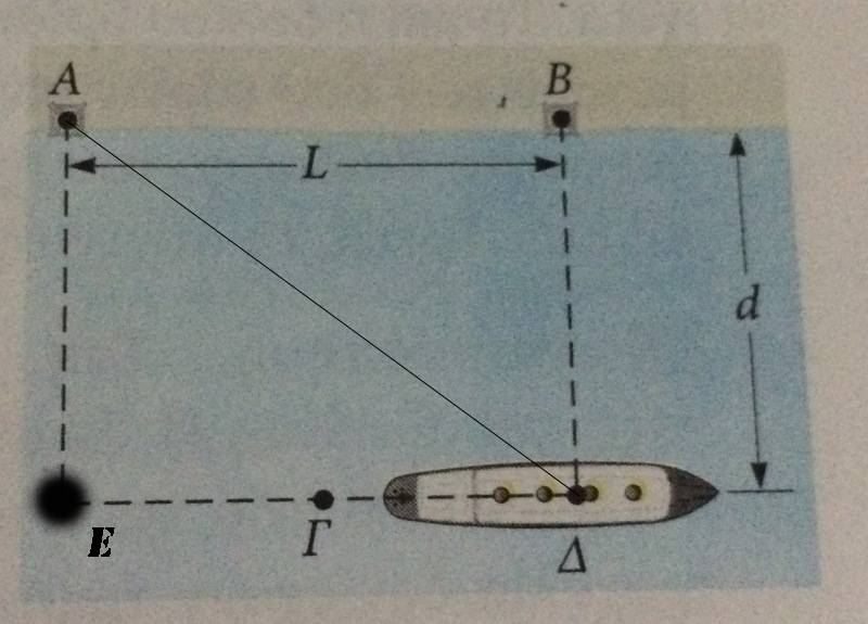

Yeah, I checked it again this morning and figured out my mistake. I messed up on the Pythagorean Theorem. But to break this down:
At Δ we have the "First Minimum", so the signals that arrive from A & B there are out of phase, and result in the Amplitude A of the combined wave being 0. Thus, Δr = n*λ/2, in regards to Δ. But it's the 1st Minimum, so n = 1. Now I need to find rA & rB, or ΑΔ & ΒΔ. ΒΔ is d = 600 m. For ΑΔ we construct the triangle with ΑΔ as the hypotenouse, as seen here:
So, ΑΔ = sqrt(L2 + d2) = sqrt(8002 m2 + 6002 m2) = 1000 m
Now we have Δr = |rA - rB| = | 1000 m - 600 m | = 400 m = 1*λ/2 <=> λ = 800 m
And that's it. I messed up the Pythagorean at first and then everything spiralled from there. I still have a question though: Why tell me that in Γ the two waves confluent in a strengthening way/A' = 2A? I didn't use it anywhere. Couldn't it have just given me the info about Δ?
