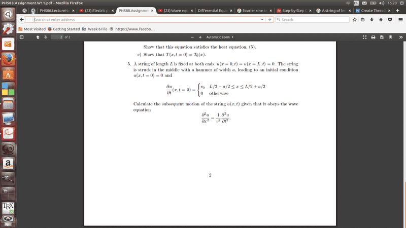

A string of length L is fixed at both ends ##u(0,L)=u(L,t)=0## The string is struck in the middle with a hammer of width a, leading to an intial condtion ##u(x,0)=0## and
$$U_t(x,0)=v_0 $$ for $$\frac{l}{2}-\frac{a}{2} \leq x \leq \frac{l}{2}+\frac{a}{2} $$
and
$$U_t(x,0)=0 $$ other wise
I have printed screen in the question Just encase it make no sense what I have wirtten
I am not going to put full working, I am having trouble with one particular part the intial condtions for my Fourier series.
$$U_t(x,0)=\sum_{n=1}^\infty \left(-\frac{n\pi c}{L}\right)B_n sin(\frac{n\pi}{L}x)$$ [1]
$$\left(-\frac{n\pi c}{L}\right)B_n=\frac{2}{l}\int _0^lv_0sin\left(\frac{n\pi }{L}x\right)dx\:$$ [2]
$$B_n=-\frac{2v_0}{-n\pi c}\int _{\left(\frac{L}{2}-\frac{a}{2}\right)}^{\frac{L}{2}+\frac{a}{2}}sin\left(\frac{n\pi }{L}x\right)dx\:$$ [3]
[3] soultuion
$$B_n=\frac{2Lv_0}{n^2\pi ^2c}\left(cos\left(\frac{n\pi }{2}\left(\frac{L+a}{L}\right)-cos\left(\frac{n\pi }{2}\left(\frac{L-a}{L}\right)\right)\right)\right)$$
I believe I have gone wrong with the limits and my problem lies in how the size of the hammer is effecting the wave in this case, could someone please advise, thanks in advace

The wave equation has a speed parameter "##v##" in it; why does your solution have no ##v## anywhere? Is your ##c## perhaps equal to the ##v## in the question?
Sorry yes my c=v my appolgise. I have also just had a throught could I use the indenties for cos(a+b) and cos(a-b) to solve this problem

I agree up to here except I don't have a minus sign. But that shouldn't affect the final answer.
$$\left(-\frac{n\pi c}{L}\right)B_n=\frac{2}{l}\int _0^l v_0 \sin\left(\frac{n\pi }{L}x\right)dx$$
That isn't quite right. Apparently the ##l## should be ##L##, but the function isn't ##v_0## on that interval. So it is better written$$
\left(-\frac{n\pi c}{L}\right)B_n=\frac{2}{L}\int _0^L u_t(x,0) \sin\left(\frac{n\pi }{L}x\right)dx$$ $$
\left(-\frac{n\pi c}{L}\right)B_n=\frac{2}{L}\int _{\frac L 2 - \frac a 2}
^{\frac L 2 + \frac a 2 }v_0 \sin\left(\frac{n\pi }{L}x\right)dx$$
[3] soultuion
I didn't check your final answer but I don't see any obvious major errors.
