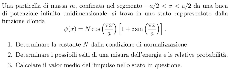

Hi guys i have this exercise:
A particle of mass m, confined in the segment -a/2 < x < a/2 by a one-dimensional infinite potential well, is in a state represented by the wave function:
1. Determine the constant N from the normalization condition.
To do this, I have to integral the square modulus of the function between minus infinity and plus infinity usually.. In this case however the integral diverges so I wonder. In cases like this can I restrict the integral in the area of zero potential (between -a/2 and a/2)? Also because only here the function is different from 0. I have already calculated this integral and I obtain that N^2 = 16/(5a). Can I accept this result?
Definitely, yes !
You may want to check that...

Thanks for the feedback. The second point reads:
2. Determine the possible outcomes of an energy measurement and the related probabilities
To do this I transformed the sines and cosines:
##\psi(x) = \sqrt{ \frac {8}{5a}} \frac {e^ { \frac {i \pi x}{a}} + e^ { -\frac {i \pi x}{a}}}{2} (1 + \frac {e^ { \frac {i \pi x}{a}} - e^ { -\frac {i \pi x}{a}}}{2})##
Multiplying the terms and then returning to writing sines and cosines I obtain:
##\psi(x) = \sqrt{ \frac {8}{5a}} cos(\frac {\pi x }{a}) + \sqrt{ \frac {8}{5a}} \frac {i}{2} sen(\frac {2 \pi x }{a})##
So psi is nothing more than a linear combination of the states with n=1 and n=2. Consequently we have only two energy outcomes:
##E_1 = \frac {\hbar^2 \pi^2} {2ma^2}##
and
##E_2 = \frac {4\hbar^2 \pi^2} {2ma^2}##
So to calculate the probabilities I have to calculate the square module of the two coefficients normalized to the sum of the two square modules. Everything is correct?
Sounds fine. And be sure the probabilities sum to 1 (as a double check) Any other sanity checks you can use? (I am terrible at Algebra and so I always search for reassuring checks and limits ... a good habit for the not-so-meticulous)
Mmh.. The sum of the probabilities is different from 1.. So should I enter another normalization constant? (Initially I thought: I just calculated a normalization constant for this purpose!!!. But actually the previously calculated N should not normalize in the case in which we consider the probability of the energy outcomes but when we consider the outcomes of x. Or am I wrong? I'm a bit confused)
Edit 1: Waitt.. If the sum of the two square modules does not equal one then we just need to divide the square module of the coefficient of one of the two outcomes by the sum of the two square modules and then we normalize everything (without adding any other normalization constant). In case we want to normalize anyway, is it wrong to multiply psi by a new constant?

The relevant normalized wavefunctions are
##\psi_1(x)=\sqrt{\frac{2}{a}}\cos\left(\frac{\pi x}{a}\right)##
##\psi_2(x)=\sqrt{\frac{2}{a}}\sin\left(\frac{2\pi x}{a}\right)##
Write the given wavefunction as a linear combination of these, not the explicit sinusoidals, as $$\psi(x)=N[A\psi_1(x)+B\psi_2(x)]$$and then simply normalize remembering that the eigenstates ##\psi_n(x)## are orthonormal $$\int_{-\infty}^{+\infty}\psi_k^*(x)\psi_j(x)dx=\delta_{kj}.$$You do not have to perform any integrals.
Likes keyzan and hutchphd

There was a quicker way. We can write:
$$\psi(x)= N\sqrt{\frac a 2}\big (\psi_1(x)+\frac i 2 \psi_2(x)\big )$$Hence:
$$p(E_1) = 4p(E_2)$$And, as these probabilities sum to 1, we have:
$$p(E_1) = \frac 4 5, \ p(E_2) = \frac 1 5$$Also,
$$p(E_1) = N^2\frac a 2= \frac 4 5$$Gives us$$N = \sqrt{\frac 8 {5a}}$$

What is $$P(E_1) = \frac{\frac {8}{5a}}{\frac {8}{5a} + (\sqrt{\frac {8}{5a}}*\frac{i}{2}+(-\sqrt{\frac {8}{5a}}* \frac{i}{2}))} = \frac{4}{5}\ ??$$
In part 1 you have established that ##N = \sqrt{8\over 5a}##. Post #11 tells you ##A = \sqrt{4\over 5}, \ B = \sqrt{1\over 5}##. So ##|c_1|^2=4/5## and ##|c_2|^2 = 1/5##.
In the alternative ##P(E_1) = \frac{|c_1|^2}{|c_1|^2+|c_2|^2}## the ##c## don't have to be normalized (that factor drops out) and the 'calculation' is $$P(E_1) = \frac{1^2}{1^2+({i\over 2}) * ({-i\over 2})}$$

Two tips here: 1) always express your wavefunction in terms of the eigenfunctions. With an unknown overall normalisation constant, if necessary. 2) You don't need to calculate the normalisation constant to get the probabilities.

In ##\psi## you have a common factor times a cosine plus ##i\over 2## times a sine. The common factor drops out and there are your 4/5 and 1/5 !
keyzan said:
Now I could insert a new normalization constant so that the sum of the probabilities is 1. But the result I get from this new normalization is:
##N = \sqrt{\frac{5a}{10}}##
For the coefficients of the eigenfunctions, the sum of modulus squares is 1). Not for the raw sines and cosines. That's the confusion.
To emphasise the point. The simplest case is where ##\psi## is an eigenfunction:
$$\psi(x) = \psi_1(x) = \sqrt{\frac 2 a}\cos(\frac{\pi x}{a})$$The coefficient when expressed as the eigenfunction is 1. Which equates to probability 1. The coefficient when expressed as a cosine is not 1.
