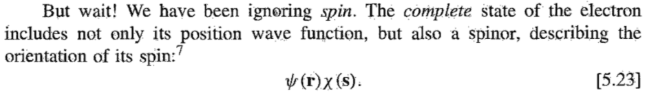

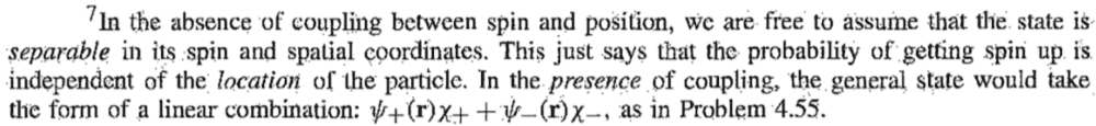

Why can't the general state, in the presence of coupling, take the form $$\psi_-(r)\chi_++\psi_+(r)\chi_-$$ where ##\psi_+(r)## and ##\psi_-(r)## are respectively the symmetric and anti-symmetric part of the wave function, and ##\chi_+## and ##\chi_-## are respectively the spinors representing spin up and spin down? In other words, why must the "coefficient" of the spin-up spinor be symmetric, in the presence of coupling?
Reference: Intro to QM, David J Griffiths, p210
You just changed the orientation of the z axis (by swapping what up and down is). Why would it be symmetric and antisymmetric? I don't know, needs more context, I don't have Griffiths around.
The part of the spatial wave function associated/coupled with ##\chi_+## does not need to be symmetric, right?
On second thought, I think ##\psi_+## does not represent a symmetric wave function, but it’s just to denote the part of the spatial wave function associated with ##\chi_+##. Throughout the book, Griffiths has been using ##\psi_+## to mean a symmetric wave function, but I think it does not mean that in this particular case, hence the confusion.
That makes more sense.
