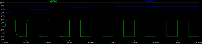

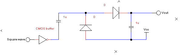

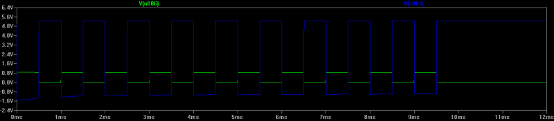

Here is a simulation of your circuit (I have guessed at some parameters, and repeated the "on" pulse). If you want a voltage doubler, try this circuit:
Feed it with a square wave of somewhere between 1 and 100 kHz. A simulation of the circuit is shown here:

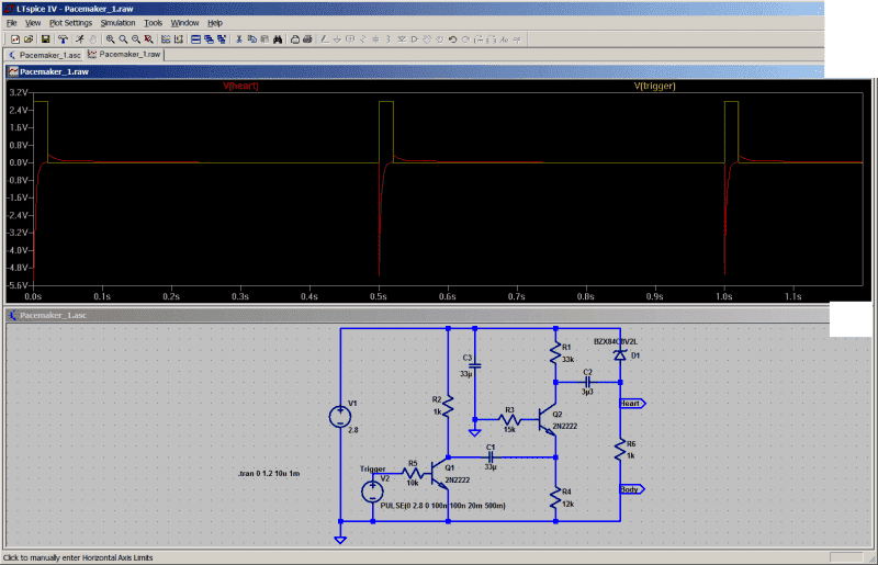

The circuit does work. It needs time to recover between triggers. Attached is pacemaker_1.txt rename to .asc to run with LTspice.
OK. To me it looks like an AC-coupled cascode circuit, which is basically a high frequency amplifier.
I may have gotten some of the values wrong in my simulation (it wouldn't have been the first time).

It is not really cascode because the base of Q2 is not clamped to a fixed DC potential.
I would call it a Marx Impulse Generator because it switches parallel capacitors to series connection.
http://en.wikipedia.org/wiki/Impulse_generator#Marx_generator
It needs a low impedance path through the body to charge and discharge the system. That is my R6 = 1k.
C1 and C2 are gradually charged to Vdd.
When Q1 turns on, C1 generates –Vdd on the emitter of Q2.
Q2 is then turned on and bootstraps C2 down to –2*Vdd.
So it is a pulse voltage doubler that operates by charging two capacitors in parallel.
When triggered it connects them in series. Hence the Marx topology.
Note: my value of R5 should be 15k, the values of R2 and R4 should have been 33k, but it makes no real difference to the simulation or function.
The problem with the OPs prototype was probably that a short positive trigger pulse was not applied to the base of Q1 through a limiting resistor each second.
