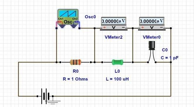

Draw a time-depended waveform of all components in DC RLC circuit.
R=4*1,412
L=1,6 mH
C=0,2 mF
Udc=15 V
DoCircuit simulator
I am a bit confussed with this homework because I am aware that capacitor do not conduct a current in DC circuit.
Can somebody help me meet my homework, please?

I am not sure how perform calculation or simulation of such a circuit.
I have here a sim, which can show AC Transient parameters but I do not know how to apply it for DC.

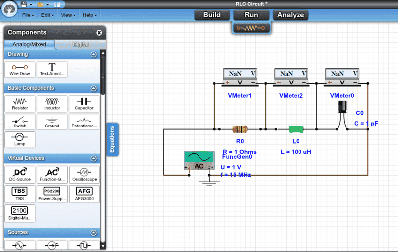

I was not able at last conduct any calculation. Actually, I don't even know how to connect the oscilloscope property.
Any help would be much appriciate. Thanks.

Going by the image, the oscilloscope has two separate channels. As you've drawn it currently you have the channels connected to either end of the resistor. It would appear that each channel will measure a signal with respect to ground reference. So if you have a ground connection specified on your circuit (as you have in the diagram connected to the negative terminal of the battery), then you need only a single wire from a channel connector to a point on the circuit. The oscilloscope should then be able to display the voltage at that point of the circuit with respect to ground. As you've drawn it currently you have the channels connected to either end of the resistor.
Try moving the ground around in order to place the oscilloscope's reference point at different locations. So for example you might place the ground at one end of the resistor and a scope channel at the other end, thus displaying the voltage across the resistor.

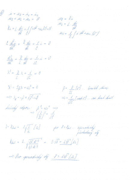

Yes, I know these equtions, actually I have calculed a critical resistor value using them (attached). But I am not sure how to applied them in accordence to obtain graphs. We can't be ask to make an analysis of them and draw the charts by hand (there's a lot more of them), can we?

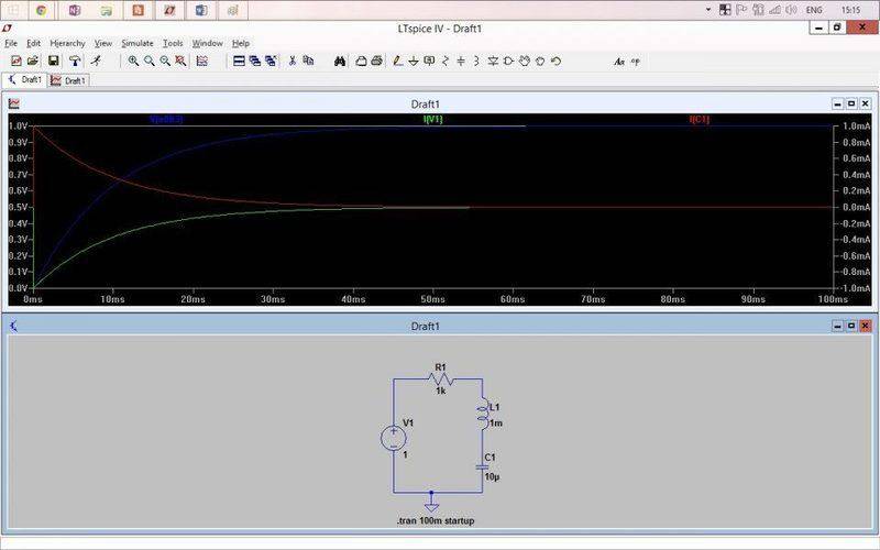

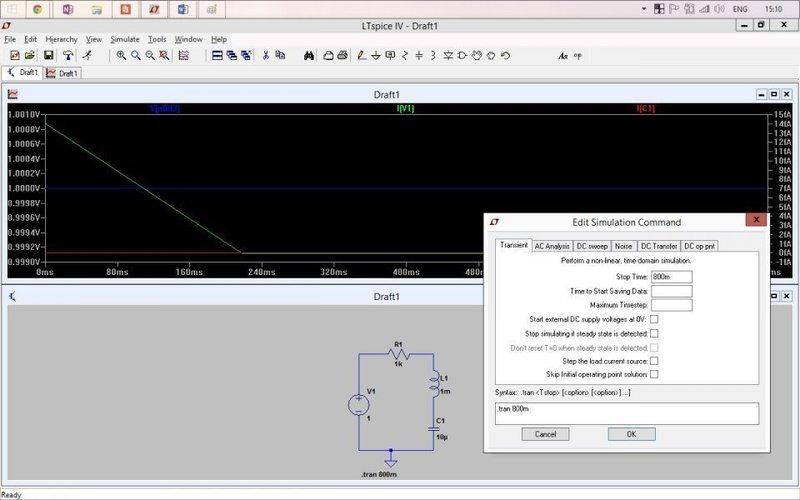

Here's printscren. Please, let me know if any futher informations are required.
I have just notice I didn't set "start at 0V" in LTSpice.
Looks good now for me. What are saying about?

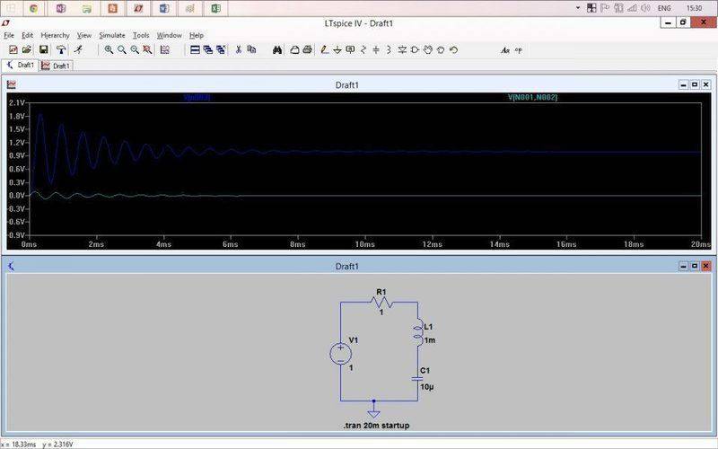

Yes - everything seems to be OK. Because of the large resistor value (1k) the system is overdamped -no oscillations.
Try a smaller value (100ohms, 10 ohms) - and you will see some damped oscillations.

One futher question - how can it be, the capator reachs in peak up to 2V while the voltage source has 1V?
The capacitor voltage rises towards 1v but overshoots and reaches 2v, before falling back towards 0. That's what your graph shows? Sounds right.
Yes -that is a "normal" effect for oscillating circuits. The "key word" behind this effect is "phase shift".
Remember that - at each moment - the sum off all voltages across the three elements must be identical to the driving voltage (KVL)
Now - because the voltages across the inductor and across the capacitor are out of phase by 180deg , both amplitudes are substracted from each other.
As a consequence, one must be larger than 1V. The remaining voltage (difference) - added to the voltage across the resistor - is identical to the driving voltage.
This can be seen in the graph of all three voltage drops: At each time slot the sum of all voltages is identical to 1V (DC input).
