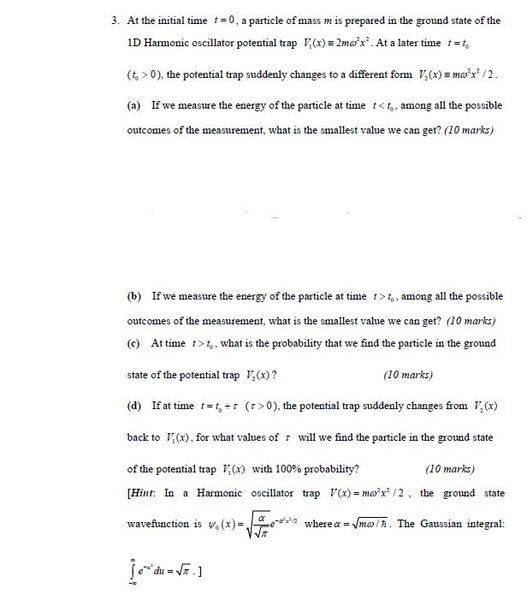

See the attachment for question and solution
See the hint in the question
In part (c), it asks about the probability of finding the particle in ground state.
As far as I know, we need to write the wave function in terms of eigenfunction first.
i.e. ψ(x,t)=[itex]\sum c_{n} f_{n} (x) e^{-iωt}[/itex]
Ground state correspond to n=0. Therefore, the probability we want is [itex]c_{0}[/itex]
Also [itex]c_{0}[/itex]=[itex]\int ψ^{*} f_{0}[/itex]
[itex]f_{0}[/itex] is provided in the hint which is [itex]\sqrt{\frac{\alpha}{\sqrt{\pi}}}e^{\frac{-\alpha^{2} x^{2}}{2}}[/itex]
But I have no idea what [itex]ψ^{*}[/itex] is.
Also I have no idea what is going on in the solution
Also, I don't understand the solution for part d, can anyone explain it to me?
Especially why n must be even?
