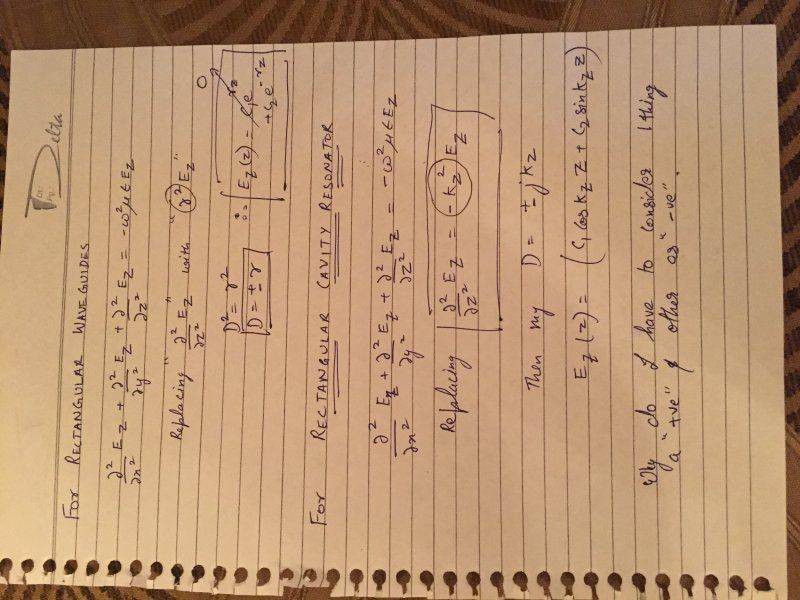

This is not a homework question and I am asking this question out of curiosity. We have been taught rectangular wave guides and cavity resonator recently and I don't want to gulp the wave equations as it is, so the problem that I am facing ( I have written it on paper and uploaded the photo) . Don't know if my question is stupid but it really confuses me .

I don't know exactly what is your problem but I assume you confuse why in rectangular wave guide we set d^2/dz^2=Gama^2 but in cavity d^2/dz^2=-Kz^2?
As you know in the wave guide we transfer a wave in Z direction and it goes through wave guide with it's wave coefficient (Beta) but in cavity a wave repeat simultaneously in the cavity in +Z and -Z direction to create a fix resonator so it should be in sinusoidal form

Yes this is what I am confused about. Thank you for reply :) , it helped a lot . So this means I am making changes in equation because I know that in resonator my wave has to be a standing wave rather being a propagating one in +z or -z direction.

Yes of course ,However you can try to solve wave equation in cavity and use separation variables to obtain it's answers after that you should add two new boundary condition ( E tangential in EZ(0)=EZ(d)=0 )that only a sinusoidal form can prove that.
