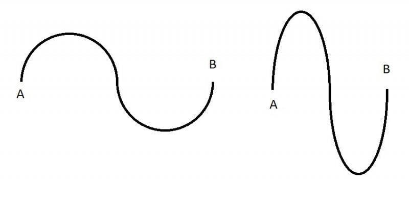

I must admit I'm although I'm fascinated by particle physics and quantum phenomena it seems i can't thoroughly understand some basic stuff, or maybe I'm just applying the rules of the macro world too much (I know at subatomic levels things are different) but it just seemed to make sense that the larger the wave's characteristics, the more distance that was being traveled if measured from a set point in a straight line. Have a look at the daigram below:
Basically the original question was asking that in some cases would the distance from A to B, be longer in some waves than others, and if so would that mean that over a set linear distance in length, that there would be more 'wave distance to travel', in effect the total distance traveled being greater, although in ilnear speed they move the same speed, which would suggest the light has to move faster. Thanks for the in depth answer by the way Dakkrah, here I'm merely trying to error proof any confused thinking i still have!
The amplitude of a light wave (forget about photons) is not a distance. It is a field strength. The light wave is not following a squiggly path through space. It is going straight and is modeled as a self-propagating change in field strength. The graphs you show above would be graphs of field strength versus time, not of transverse position versus time.

Thanks jbriggs444, I always thought of the wave as a literal representation of the light through space, as frequency is after all cycles per second and the amplitude i always thought of as a physical 'length' rather than 'strength'.
