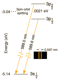

why sodium has two lines D1 and D2 ?
it may be due to transition between s1/2 and p3/2, p1/2 and p3/2 states
Those are transitions from two fine levels.
That's [tex]^2P_{1/2} \to ^2S[/tex] and [tex]^2P_{3/2} \to ^2S[/tex] :smile:
In addition to ZapperZ's link, there is
http://hyperphysics.phy-astr.gsu.edu/hbase/quantum/sodzee.html#c1
which has this image:
