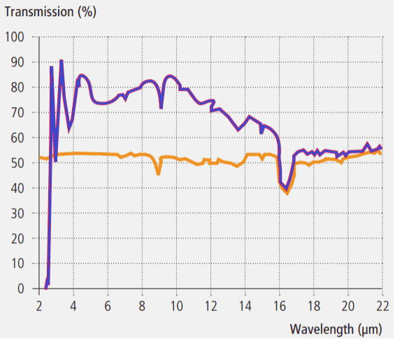

Yes I will only have a difference between the two temperature readings but I was hoping this could provide more information. The thermopile detector has a filter on it currently so for example if the temperature of the blackbody is at 90 degrees and the secondary temperature sensor reads 90 but the thermopile reads 80 - is there no way of extracting what type of wavelengths may have been blocked out by the filter?
This filter will be removed at some point in the future. The data sheet has this graph and I am confused how they worked out the transmission % at each wavelength because I would like to reproduce this graph and technique so I can test performance outside of the wavelengths shown on this graph. (image attached).

Ok, that helps. But I fail to see how a filter will succeed in maintaining a temperature difference in a confined space. The filter itself will get hot, reradiate, etc. The thermopile will be subjected to a distorted spectrum, but must still converge on the ambient temperature.
Presumably it also has some explanation of what is being plotted. It is impossible to interpret out of context.
Unfortunately it does not.
