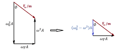

Express the equation of motion (2nd order differential equation) for this forced oscillator
b.
Draw a vector diagram representing the equation of motion in general. Then, derive and express the resultant amplitude A and phase shift Φ. Make sure to draw arrows for vectors and the direction of the angle, φ.
Fo/mcosωt = ψ +γψ + ωo2ψ
I'm not sure how to put dots to signify derivatives, but the first ψ is the 2nd derivative and the second one is the first derivative.
I think the equation of motion is just as I wrote it previously. I need a little help with the vector diagram. I'm just having a little trouble understanding them. My professor is jusr OK and I don't really care for the book. I've uploaded some work I did on scratch paper, so if anyone could point out mistakes or give me some tips, I would greatly appreciate it. Thanks in advance.
  • Scan0026.pdf
Your diagram looks OK to me. It would be nice to include arrow heads on all the vectors, and the diagram should be closed (the ω2A vector should meet up with the tip of the Fo/m vector).
Use simple geometry or trig on your diagram to express the length of the vector ωo2A in terms of the length of the vector ω2A and a projection of the Fo/m vector. Likewise, try to find a way to express the length of the γωA vector in terms of the Fo/m vector.
[EDIT: It looks like you already have equations that you can solve for the amplitude A and phase angle. For the phase angle, it might be easier to work with the tangent of the angle rather than the cosine. Anyway, it looks like you have already essentially solved it. Do you have a specific question regarding the solution?]
So I have (Fo/m)sinΦ=γωA and tanΦ=γω/(ω^2o2) It seems to me like I'm missing some final piece to the puzzle. I think I may be too tired and just need to sleep on it.

Before thinking about the approximation, there is something you can do that simplifies the vector diagram even when you are not making an approximation. Note that the two vectors ω2A and ω02A are always in opposite directions. So, you can always combine them into one vector as shown:
And so the diagram reduces to a right triangle:
For the case where ω<< ω0, how would you approximate the blue vector (ω02 - ω2)A?
For weak damping, how should the length of ωγA compare to the length of the blue vector?

In that case, I believe I would approximate (ω^2o2) as just ω^2oA. Also ωγA should be much shorter than the blue vector.
Yes. From a sketch of the figure corresponding to these two conditions, you can use a small angle approximation to get simple expressions for A and ∅.
I came up with Φ=γω/(ω^2o2) and A=(Fo/m)/(ω^2o2).
Yes. That’s what I get, too. Hope that’s what they wanted.
You can simplify the denominator for A and Φ
Because ω<<ωo, can I say the denominator is just ω^2o?
I think so. By dropping ω2 compared to ω02, your answers are still accurate to first order in the small quantity ω/ω0.
