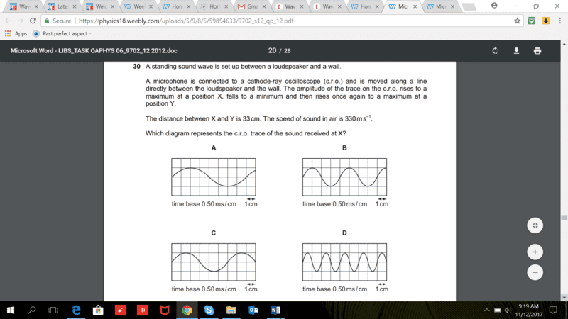

I want to ask about question 27 in Cambridge university physics paper 9702/01 of October/November 2008
https://physics18.weebly.com/uploads/5/9/8/5/59854633/9702_w08_qp_01.pdfand question 30 in Cambridge university physics paper 9702/12 of May/June 2012.
https://physics18.weebly.com/uploads/5/9/8/5/59854633/9702_s12_qp_12.pdfIs the motion of the transmitter or receiver important?
Are they both about standing waves and that is why the distance between the neighboring maxima = half of the wavelength?
Are these questions the same?

** First, please take screenshots of the two problems, and Upload them to your next Reply. It's a bit unreasonable to ask helpers to look through two long PDF files to try to find the problems you are asking about.

I can try to do it for you, but all you have to do is take Windows screenshots of the individual pages, and paste them into JPEG images in Paint or a similar program. Are you familiar with using Alt-PrntScrn to take screenshots in Windows?
How do I take into account the motion of the source or the receiver?

It looks like it is just a matter of constructive and destructive interference as a function of position along the axis in each question. There is no Doppler component in the motion part of the questions, IMO. Is htat your question?

Why do you say that? To include the Doppler effect, we would need to know the velocity of the receiver,.

Can you post the Relevant Equations for simple constructive/destructive wave interference problems like these? :smile:

For the constructive interference the phase difference must be multiple of 360 degrees.
For destructive interference the phase difference must be odd number of 180 degrees.
That's pretty close. So can you apply those rules to the 2 problems to solve them?
