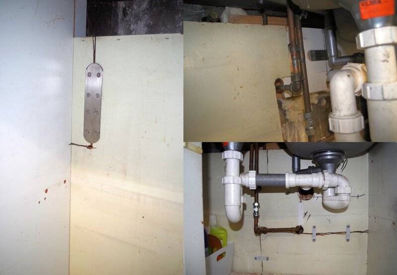

Tangential, but I was faced with re-assembling under-sink back-board in-situ after repairing waste pipe where it ran through wall.
Said pipe gnawed by rats within wall would you believe ?? Took ~15 mins to replace the push-fit pipe, many miserable months to dry out then re-instate the rest...
For the panel's thick bracing, I could use threaded inserts, mending plates with 4x2 holes and allen-keyed bolts. Inserts placed before sawing. For the thin panel, I used metal 'winged' inserts that, spread by recommended tool, gripped panel and provided a threaded hard-point. "Jack Nuts - Screw Anchor - Spider Nut - Hollow Wall Sleeve - Steel, 25, M5"
Then simpler mending plates and more allen-keyed bolts to stitch seam...
See pic collage...
