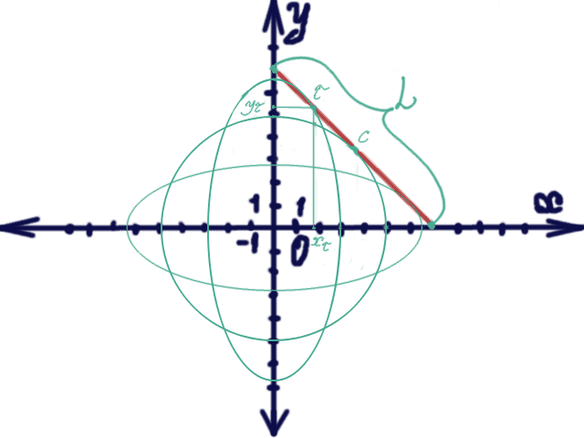

The problem: We have a segment of the line, the endpoint of which is stocked to the Axes, different endpoints, to the different axes. This segment is moving. We must show that any point of this segment will have ellipse-like trajectory, for an exception for the center point and endpoints. - I hope you will understand it, because I am to lazy and sleepy to draw a GIF-animation of the motion.
So I have mind activity for a while...
And I have draw a lot graphs on ma paper stuff for the special case - Isosceles right triangle position of the line-segment, and I have draw a many kind of trajectories there, so I have decided to try the ellipse-like trajectories in the center of origin of Coords. And then I have start to check this trajectories.
For the first, for the Center point, which is C on the graph stuff. I have remembered Pythagorean stuff in the case of Isosceles right triangle,
Also I have remembered something about Thales' theorem, and stuff about equal segments of the angle sides, so I have found M and M' points. This points will be semi-self-axis in our guessed Ellipse, so they will be equal, if they equal our Ellipse, will be something like Circle. I have decided to invoke the same trick for the point tau,
The semi-axes was not equal so we have an Ellipse. Than I decided to check if this point is the point of Ellipse and the Line Segment in the same time.
So we have 8 points (I like Symmetry sometimes ^^), that is points of the Ellipse and the Line Segment in the same time, during the motion of the Line Segment, I think it is enough to say that we have Ellipse trajectory of the all points, except three special :P .

What can be said about ##\sin \theta## and ##\cos \theta## based on the coordinates of ##x## and ##y## of P ?
If you know then just put those in ##\sin^2 \theta + \cos^2 \theta = 1##.
$$\sin{\theta} = \frac{y_{p}}{\left( PB \right)}, \cos{\theta} = \frac{x_{p}}{\left( AP \right)} \Rightarrow \frac{{y_{p}}^{2}}{{\left( PB \right)}^{2}} + \frac{{x_{p}}^{2}}{{\left( AP \right)}^{2}} = 1 \sim \frac{x^{2}}{a^{2}} + \frac{y^{2}}{b^{2}} = 1 \Rightarrow \text{An Ellipse!}$$ It is looks like a Ellipse stuff, our segments of our segment will be constant for the any particular P - point (well they will flip into each others, but due to the symmetry - it is ok), and if the point will be on center of our segment, the hypotenuses will be equal, so the denominators will be equal too, so it will be a Circle case. It's make a sense. And much more better than ma' attempt to solve.
