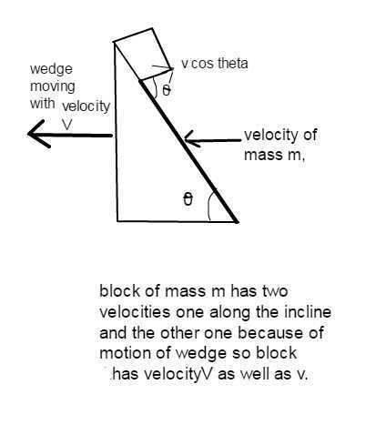

:block slides on smooth triangular wedge kept on smooth floor.Find velocity of wedge when block reaches bottom.
(image is attached)
:Let the velocity of the triangular wedge be V.And v be the velocity of block m.
[/B]
applying conservation of linear momentum in the horizontal direction we get
MV +m(v cos theta -V)=0
And because of conservation of energy
1/2 MV^2+1/2 m[(v cos theta - V)^2 +v sin theta]^2
The answer comes out to be
:I understood all these except conservation of linear momentum part.
here
MV +m(v cos theta -V) is final momentum
and 0 is taken as initial momentum.
why their initial momentum and velocity is taken as zero?I have learned in constrains, force responsible for motion of wedge is Nsin theta which is always there as long as block and wedge are in contact.And similarly motion of block is because of mg sin theta which should be always there if block is on the wedge.Then which initial condition are you referring to when these forces are not there so that they have zero velocity?I know we are taking blocks and wedge as our system now so normal forces become internal and cancels out.This problem must be a part of kinematics,Kinematics is the branch of classical mechanics which describes the motion of points, bodies (objects) and systems of bodies (groups of objects) without consideration of the causes of motion.
But I am confused why initial momentum is zero?

Nothing is moving initially, right?
AlephNumbers said:
initially,
That's what I want to know.What really is initial condition?When block was not placed on wedge?
The problem text is not clear. Did you copy it correctly?
The initial condition should be both velocities (that of the wedge and the block) and the position of the block. As the velocity of the block is asked when it reaches the bottom of the wedge, it must start from some height h. The simplest initial condition is that the whole system is in rest when the block is at height h.

Yes, I talk about your problem. The whole system can be initially in rest if you keep it in rest, and it starts to move when you release it.
By the way, the solution you cited is valid for the initial condition that the block was at height h initially, and the system was in rest.

You should place that block on to the wedge at some time. Before that, the wedge is in rest. When you place the block on it, the block is also in rest. The whole system starts to move when you release the block.
Before you release the block, your force also acts, and the net force is zero.

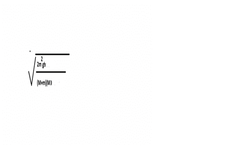

You wrote the equation concerning the momentum of the system. Conservation of energy also can be used. You made little mistakes in both equations in the OP. Check the signs and parentheses.
With the help of both of these principles I solved for v.And my answer is in post 3.
- MV +m(v cos theta -V)=0
is it correct now?
is it correct now?
Now it is correct.
Likes gracy
mgh=1/2 MV^2+1/2 m[(v cos theta - V)^2 +(v sin theta)^2]
is it correct now?

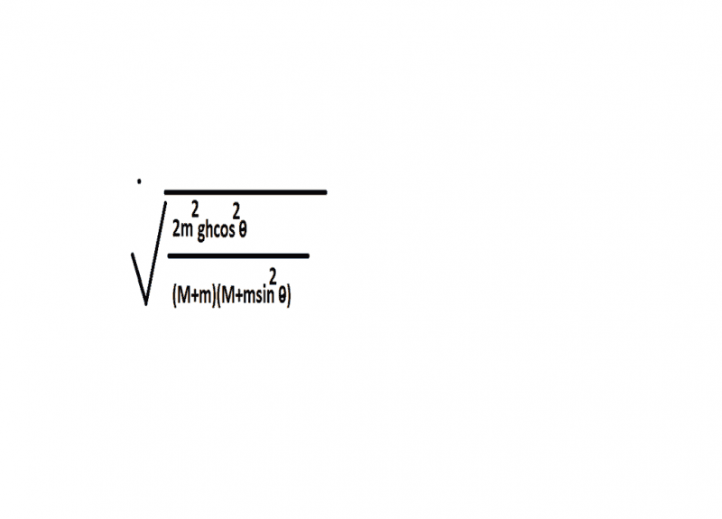

You said v was the speed of the block with respect to the wedge. Is the formula in Post#3 really for v? The question is the speed of the wedge, V.
  • #31
is it correct now?
Yes, it is correct.
  • #32
No.Sorry.Thankfully Typo.The formula is fo V.I forgot to press caps lock.

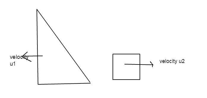

This question has one more part.
If the block comes down(i.e block is now no longer on wedge)what is the velocity of wedge?
  • #34
  • #35
My doubt is that now block is not on wedge,so force which was responsible for motion of block is no longer there.So block should have constant velocity that is same as it's velocity when the block was at bottom most part because after that force was removed (as block came off from wedge)
