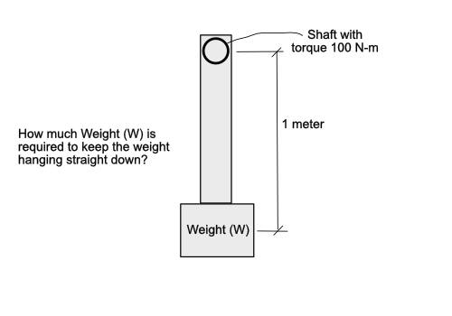

How much Weight (W) is required to keep a weight hanging straight down when the torque is known on a rotating shaft? Please see attached image. Assume a lever weight of zero to keep it simple.

MoMan said:
How much Weight (W) is required to keep a weight hanging straight down when the torque is known on a rotating shaft? Please see attached image. Assume a shaft weight of zero to keep it simple.View attachment 303451
Suppose that the shaft is deflected so that it does not hang straight down. Suppose that it is deflected by ##x## meters rightward, for instance. Do you know how to calculate how much restoring torque results from gravity pulling on the deflected weight?

The way to answer this question with infinities: The torque of weight around the central point of the shaft is ##T_W=W\cdot 1m\cdot \sin 0##. For any finite W this equals to zero and hence the total torque will be equal to the torque from shaft and it will rotate the weight.
However if ##W=\infty## then $$T_W=\infty\cdot 0=\text {maybe something finite and equal to -}T_{shaft}$$ and hence for infinite weight the system might not rotate.

At what point do macro scale accelerations become imperceptible? Can we not effectively consider the rotation of ##0.1 ^{\circ}## over 10 years as effectively no acceleration. We do this kind of thing all the time in our modeling.
Well after the point at which suspended weights break the mechanism.
