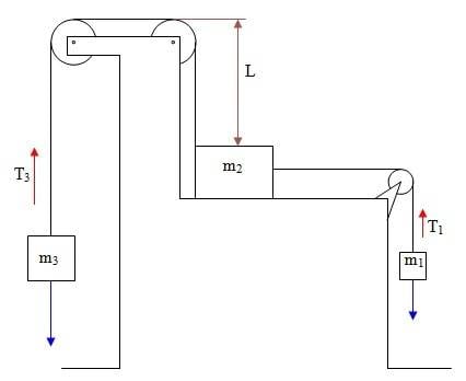

No friction. m3=5m, m2=12m, m1=3m
Prove that the system's acceleration when it's released is a=0.2g. is it the max acceleration?
Show that the equilibrium point is at x0=0.75L
Show that the kinetic energy of the system is E=mgL
Show that m2 will stop momentarily at ##x_1=\frac{15}{8}L##

m2 accelerates distance x but the rope lengthens by:
The cosine rule:
$$l_1^2=x^2+\frac{L^2}{\sin^2\alpha}-2x \frac{L}{\sin\alpha}\cos\alpha$$
$$\Delta l=\frac{L}{\sin\alpha}-\sqrt{x^2-\frac{2L}{\tan\alpha}x+\frac{L^2}{\sin^2\alpha}}$$
$$\left\{ \begin{array}{l} m_1g-T_1=m_1\ddot x \\ T_1-T_3\cos\alpha=m_2\ddot\Delta l \\ T_3-m_3g=m_3\ddot\Delta l \end{array} \right.$$
It's complicated, Δl and it's derivative and i am afraid it won't get to a second order differential equation.

The initial state:View attachment 88066
$$\left\{ \begin{array}{l} m_1g-T=(m_1+m_2)a \\ T=m_2a \end{array}\right.\;\rightarrow a=\frac{3}{27}g=0.11g$$
It's wrong.
The net force on m1 is m1g-T. And force = mass times acceleration.
$$\left\{ \begin{array}{l} m_1g-T=m_1a \\ T=m_2a \end{array}\right.\;\rightarrow a=\frac{3}{27}g=0.2g$$

I correct the original set of equations:
$$\left\{ \begin{array}{l} m_1g-T_1=m_1\ddot x \\ T_1-T_3\cos\alpha=m_2\ddot x \\ T_3-m_3g=m_3\ddot\Delta l \end{array} \right.$$

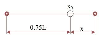

I guess the equilibrium point isn't in the middle of the path:View attachment 88357
The total energy of E=Lmg must be also at the right end of the path, x is the distance to the right of the equilibrium point x0:
$$Lmg=m_1gx-m_3g\left( \sqrt{L^2+(0.75x)^2}-L \right)$$
$$Lmg=m_1gx-m_3g\left( \sqrt{\frac{25}{16}+\frac{3}{2}Lx+x^2}-L \right)$$
Complicated
Initially you defined x as the displacement of m2 from its initial position, when the string connected to it was vertical. Write the potential energy in terms of that x. It would be much simpler. Square the equation and solve.
$$2\cdot Lmg=m_1gx-m_3g\left( \sqrt{L^2+x^2}-L \right)\quad\rightarrow \quad 3x+3L=5\sqrt{L^2+x^2}$$
And the solution is imaginary.
ehild said:
I considered the initial potential energy zero, and found the point where it is zero again. In this way, the equation was even simpler.
I don't know how to do it, i think i made it in the previous equation since ##2\cdot Lmg=...##

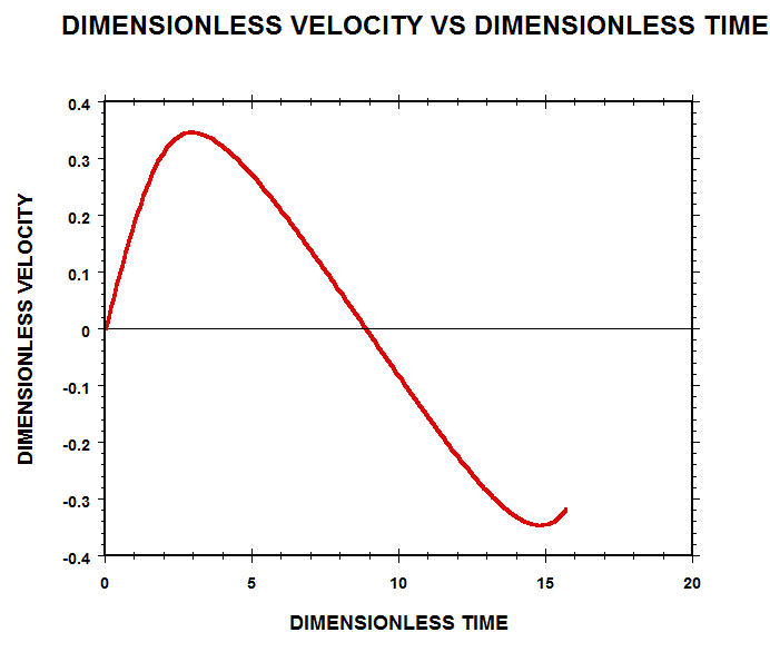

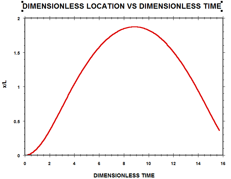

The problem is not completely solved yet. The question "is the initial acceleration maximum" is not answered correctly, and I think, a simple answer is expected, without deriving the formula for d2x/dt2. And the question is sloppy as the acceleration of m1 and m2 differ from that of m3.

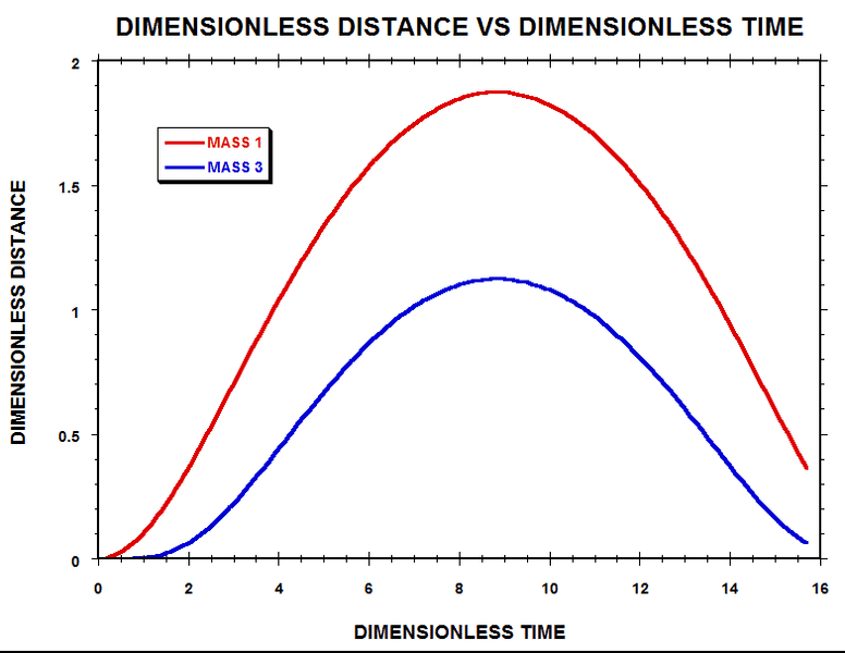

Here's something else weird to think about. The acceleration of masses 1 and 2 is ##d^2x/dt^2##, but the acceleration of mass 3 is
$$\frac{x}{\sqrt{L^2+x^2}}\frac{d^2x}{dt^2}+\frac{L^2}{(L^2+x^2)^{3/2}}\left(\frac{dx}{dt}\right)^2$$
So when masses 1 and 2 are not accelerating, mass 3 is accelerating (unless dx/dt = 0, which it is not). So at the "equilibrium position" x = 0.75L , mass 3 is not in equilibrium.

Hi guys,
For your consideration, I've solved the equations numerically for the velocity and the location x as a function of time. First I reduced the differential equation to dimensionless form by introducing the following dimensionless parameters:
$$X=\frac{x}{L}$$
$$T=t\sqrt{\frac{g}{L}}$$
$$V=\frac{dX}{dT}$$
$$M_1=\frac{m_1}{(m_1+m_2+m_3)}$$
$$M_3=\frac{m_3}{(m_1+m_2+m_3)}$$
Then I substituted these into the differential equations to obtain:
$$M_1-M_3\frac{X}{\sqrt{1+X^2}}\left[1+\frac{1}{[1+X^2]^{3/2}}V^2\right]=\left[1-\frac{M_3}{1+X^2}\right]\frac{dV}{dT}$$
$$\frac{dX}{dT}=V$$
The numerical solution to the equations is shown in the figures below:
Note that the maximum distance is X = 15/8=1.875

It is amazing, Chet! It is clearly shown how asymmetric the motion is. Could you please plot the motion m1 and m3 together?

You can see from Chet's velocity plot, that it is less steep after the equilibrium point.
No problem. The maximum on m3 is 9/8.
