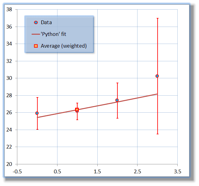

Hello! I really don't know much about statistics, so I am sorry if this questions is stupid or obvious. I have this data: ##x = [0,1,2,3]##, y = ##[25.885,26.139,27.404,30.230]##, ##y_{err}=[1.851,0.979,2.049,6.729]##. I need to fit to this data the following function: $$y = a (x+0.5)/4.186 + b$$ So basically a straight line (the other constants can be easily absorbed in the obtained values for a and b). I did this fit using Python and I get this values: ##a = 3.78 \pm 1.70## and ##b = 24.99 \pm 0.66## and the off diagonal value of the covariance matrix is ##-1.03##. First of all, the y values are all equal to each other, within the given errors, so I expected the value for a to be also consistent with 0 i.e. something like ##3 \pm 4##, but my value seems to be 2 sigma away from zero. Does that make sense (again please forgive my lack of knowledge in statistics)? Also, why is the covariance -1? I remember that if the variables are so well correlated is not a good sign for a fit. Does my fit makes sense? Is there anything I can do to improve it? Thank you!

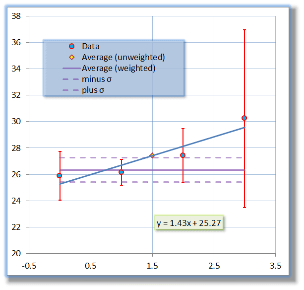

FIrst thing to do in such a case (and many others!) is make a plot of the data:
The blue points are your data and the red lines indicate the given errors. They came with the data points and can be classified as internal errors.
(As opposed to external errors that follow from the scatter of the data. -- I hope I have this right, and perhaps someone has a good reference ?)​
I added some ornaments:
The blue line is a linear fit without weights. It yields ##y = (1.43\pm0.41) x + (25.27\pm 0.76)## (The errors are found using Excel | Data | Data Analysis | Regression ). With only four data points the error on the error estimate is some 50%, so we really should report only ##y = (1.4\pm0.4) x + (25.3\pm 0.8)##. The blue line goes through the unweighted average point ##\ (x_{\sf avg},y_{\sf avg})=(1.5,27.4)\ ## in the middle.
The purple line represents the weighted average ##y## with the dashed lines at ##\pm \sigma##. As you say, all data are consistent with ##\ y = 26.3\pm 0.9##
[Edit] made an error in the error --- I should have said the weighted average is ##\ y = 26.3\pm 0.4## :nb) which means two points are outside ##\pm\sigma##.​

I'm not good at weighted stuff, but I made an attempt to at least visually represent your results:
Same figure with your fit result, now with a weighted average ##\ (x_{\sf avg},y_{\sf avg})=(0.99,26.34)\ ## in the middle.

As you can see, the fit result is quite consistent with the data. Note that for
weighing, only the relative errors count (i.e. the errors relative to each other): a single common factor for ALL errors does not change the result. Due to the relatively large errror in the 4th point, it hardly contributes (weights are 0.29, 1.04, 0.24, 0.02). So it's hardly surprising the first three points determine the result and the weighted average is very close to the second point.
If error estimates are completely right, about 32% of the data are more than one sigma away from the fit. For your data that would start to happen if you divide all the error estimates by 3 (i.e. increase all weights by a factor of 9 !). The fourth point would be at 1 ##\sigma##. More importantly, a slope ##a=0## would look very unlikely (still, with real statistics, 5% of data are outside ##\pm 2\sigma##).
Now about this correlation in the estimated errrors for ##a## and ##b##. I have shown these average points in the plots for a reason: linear fit lines always go through those points and the lines can be moved in two independent ways: wiggle (affecting ##a##) and move parallel up and down (affecting ##b##). Independent, so at that point the errors are uncorelated. repeating the fit after subtracting the 0.994 from all ##x## should yield zero correlation. Something worth checking and easily done.
With your original x-scale the wiggling influences the y-axis intercept much more than the shifting up and down, and that's where this -1.03 correlation comes from.
