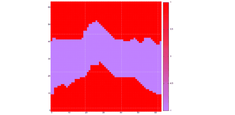

Not 100% sure this thread belongs in this section, sorry if it's out of place.
I was trying to run a simulation of a 2D Ising model; i thought everything was going fine until I started to look at the numerical results and I noticed that I get some wild fluctuations in my results; as an example, here are the values i get for final energy and magnetization (per site) after 10 different 10000-step runs on a 128x128 lattice at temperature T = 0.1 K(critical temperature is at 2.27 K), where the initial spin configuration is chosen randomly(+1 or -1 is assigned to each node with equal probability):
$$ (E, |M|) = (-2, 1); (-1.95, 0.52); (-2, 1); (-1.95, 0.21); (-2, 1); (-1.95, 0.02); (-2, 1); (-1.95; 0.24); (-2, 1); (-2; 1) $$
With a temperature so low I would expect all [itex]|M|[/itex] to be exactly 1, or at least that fluctuations like these would be way less probable than 4/10, so I guess there must be some error in my code. Am I wrong in thinking this?
I would be very grateful if someone could take a look at my code and maybe point out where the error is, cause it seems like I can't find it.
Here is the function used to update the lattice(it's Metropolis algorithm):

The main function, besides declaration of variables and error checking, is basically just
Code:
  E = energy(pLattice, s);
  M = magnetization(pLattice, s);
  for(i=0;i<R;i++){
    update(pLattice, s, probLUT, &E, &M);
  fprintf(stderr, "E = %f; M = %f\n", (double)E/N, (double)M/N);
where N is the number of nodes.
The difference in energy value between "correct" and "weird" runs is small, so when I average over lot of runs for each T, and for many values of T, the plot EvsT
looks not too different from the expected curve; the plot of |M|vsT still shows the correct behaviour, but instead of getting constant |M|=1 for [itex]T<T_c[/itex] i get values oscillating around |M|=0.8. I tried running for different times, different lattice size, different initial conditions, with no different results.
I'll post full code, graphs or whatever if needed. Thanks.
Technology news on Phys.org

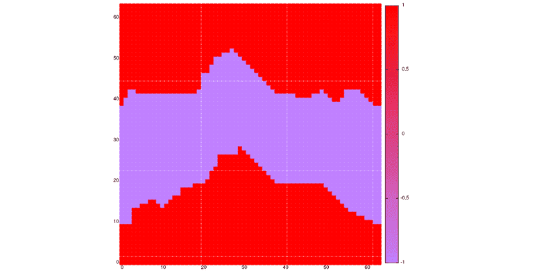

Updating just in case anyone happens to come by and help me out. I created some animated plots for the 'weird' results and I found that they correspond to situations where two connected clusters(one for each spin) arise and reach some sort of equilibrium configuration where they are just translated (always) in the [itex]-x[/itex] direction through the periodic boundary. Here a few pics of a 64x64 lattice taken at times 850,851,852,856:
Basically it evolves for some time, then stabilizes on a configuration like this which is mantained for the rest of the simulation. This makes no sense at all to me: why would something like this happen? and how? I also tried rewriting the program all over, without looking at the original one, but I get the exact same thing. I guess this must be related to the periodic boundaries, so I'll try to implement free boundaries and see what happens.
