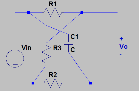

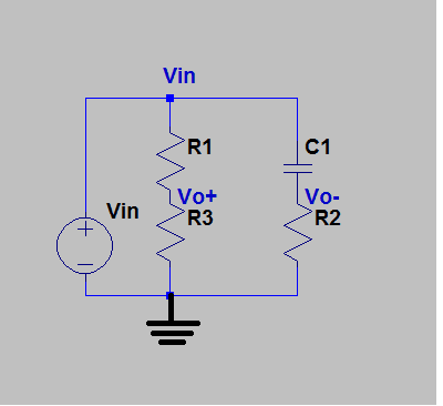

This is kind of what the circuit looks like:
KCL

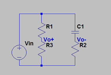

This my attempt at "normalizing" it:
Solving Attempt:
##\frac{V_{in}-V_o}{R_1}+C_1\dot{V_{in}}=0##
##\frac{V_o-V_{in}}{R_1}+\frac{V_o}{R_3+R_2}=0##
Are my equations correct?

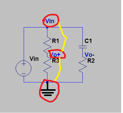

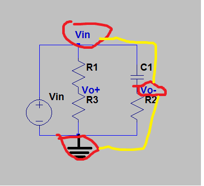

No. The output voltage does not involve ground (-ve terminal of Vin). Hence, Vo=Vο+-Vo-. You need to use both Vo+ and Vo- in the KCL equation.
Also, voltage across the capacitor is not Vin as you have taken in the first equation.
What exactly is the question asking for?
Likes Carrock
Sorry, I thought I wrote it out. The prompt is "Find the differential equation for Vo"
node vo+ (Vo+ = Vop, Vo- = Vom)
##\frac{V_{op}-V_{in}}{R_1} + \frac{V_{op}-V_{om}}{R_3+R_2}=0##
##C_1(\dot{V_{om}}-\dot{V_{in}}) + \frac{V_{om}-V_{op}}{R_2+R_3}=0##

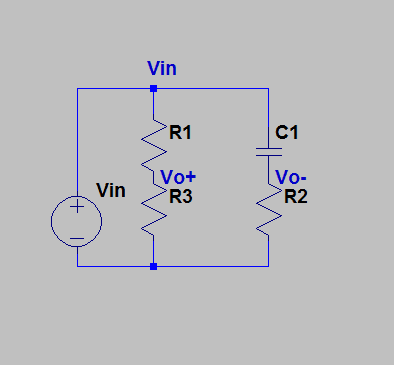

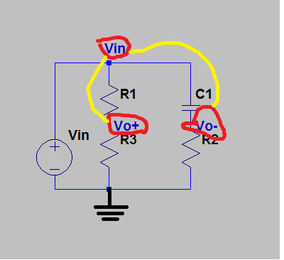

I didn't follow your equations. Basically, the currents do not add to zero. You are taking only two currents out of three. I think KCL method is not useful here.

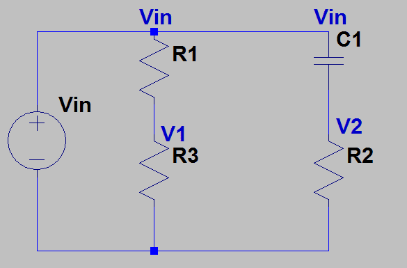

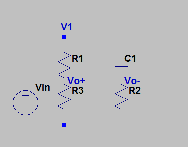

Is this better?
Vo+ = V1
Vo- = V2
##\frac{V_{in}-V_1}{R_1} + C_1(\dot{V_{in}}-\dot{V_{2}})=0##
##\frac{V_1}{R_3}+\frac{V_1-V_{in}}{R_1}=0##
##\frac{V_2}{R_2}+C_1(\dot{V_2}-\dot{V_{in}})=0##
The currents do not add to zero. I believe you need to use a different method. I'll get back to you on this later.

Nodal analysis is doable, you just have to recognize how to apply it. It might help if you were to forget +Vo and -Vo labels for a moment and replace them with V1 and V2 (Hence Vo = V1 - V2). Find V1 and V2 separately.
##\frac{V_{in}-V_1}{R_1} + C_1(\dot{V_{in}}-\dot{V_2}) = 0##
##\frac{V_1-V_{in}}{R_1}+\frac{V_1}{R_3}=0##
##\frac{V_2}{R_2}+C_1(\dot{V_2}-\dot{V_{in}})##
What is wrong with my equations?
The first one is not a node equation. Vin is not an essential node, it is part of the reference supernode since it has a fixed potential with respect to the reference node.
The second equation is good. Solve it for V1.
The third equation is also good. Solve it for V2.

##R_3V_1-R_3V_{in}+R_1V_1=0##
##V_2+R_2C_1\dot{V_2}-R_2C_1\dot{V_{in}}##
##V_1=\frac{R_3V_{in}}{R_3+R_1}##
##V_2=R_2C_1(\dot{V_{in}}-\dot{V_2})##
##V_o=V_1-V_2##
##V_o=\frac{R_3V_{in}}{R_3+R_1}-R_2C_1(\dot{V_{in}}-\dot{V_2})##
How would I get rid of ##\dot{V_2}##?

Solve for V2 before you combine with V1. The V2 equation is a simple differential equation. Hint: What is ##\dot{V_{in}}##?
gneill said:
Please do not edit content out your previous posts. It makes followups discussing that content nonsensical. If you do edit a post, make sure that you leave a note in the post indicating what changes you made and why. It is best to have a policy of only adding to a previous post, not removing content. Fixing typos is fine.
I edited that post on accident and didn't know how to undo. My bad.
##V_{in} = V_1(1+\frac{R_1}{R_3})##
##\dot{V_{in}}=\dot{V_1}(1+\frac{R_1}{R_3})##
##V_2=R_2C_1(\dot{V_1}(1+\frac{R_1}{R_3})-\dot{V_2})##
