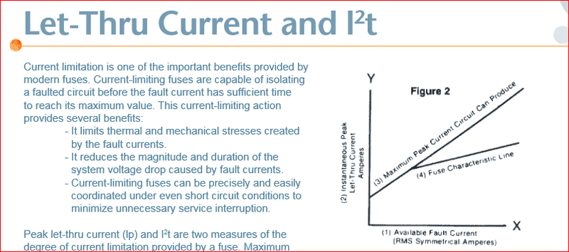

Hi friends ,
today we are just general talking with my boss. and he asked me a question . and that is,
if we have equipment that is rated short circuit current is 40kA. for 1 sec. and if we must have to use that same equipment for 3 sec time. that how much short circuit current they can sustain for 03 sec time, definitely below than 40kA. but how much with respect to time ie 3 sec. let say 10kA , 20kA , 30kA, or 39.8kA. ..
this is completely just discussion not practically by any mean please.
thanks

Completely indeterminate given the information you have provided. It's going to depend on the specifics of the particular equipment.
i suspect boss is leading you to self educate on this subject
http://ep-us.mersen.com/fileadmin/catalog/Literature/Application-Guidelines/ADV-P-Application-Information-Let-Thru-Current-and-I2t.pdf
many devices give an I^2t rating so you can choose a breaker or fuse to protect it. Search also on "fuseology"
For something that burns, heat is developed by I2R. Lots of equipment will fail in this mode, but it's not the only failure mode.
