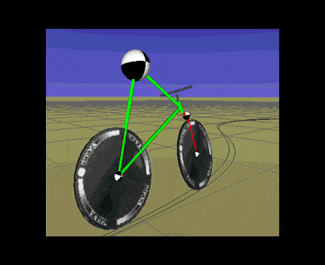

  • #59
Lnewqban said:
alternating steering input
I went through the wikipedia link that you've posted above. However, i couldn't find the term alternating steering input that you've mentioned. Could you kindly let me know what the the term alternating steering input means in the context of the bike.[/B]
  • #60
In context, the relevant quote from @Lnewqban is:
Lnewqban said:
Please, note that such balance is instable, as the CM is located "above" the point or area of support (tire-vertical wall).
The alternating steering input of the rider trying to keep the above condition real, is the only way for any single-track two-wheeled machine to keep balance (just like it happens when rolling on a perfectly horizontal surface).
The idea is simply that a bicycle is unstable. Positive feedback. Tip a little, tip a lot and fall. In order to maintain something like a stable upright position, one needs some negative feedback. The standard way of providing this is with a rider who will steer the wheels right to prevent a rightward tip and steer the wheels left to prevent a leftward tip.
This will typically be done with alternating steering inputs. Left until it tips right then right until it tips left and so on. This video by Veritasium shows what happens when you lock the steering from being able to go one of those two ways.
Yes, we understand that riding a bicycle is not quite as simple as blindly rocking the handlebars back and forth. But there will be some back and forth involved.
Edit: Skilled riders can maintain an upright bicycle without steering input in a manner akin to tight-rope walkers. They trade off angular momentum (in the "roll" direction, not "pitch" or "yaw") for a sideways thrust with the tires on the pavement. A long pole can provide a nice pool of angular momentum to tap. Like this.

  • #62
I have made that term up, sorry it is confusing.
Alternating steering to one side and the other is what I meant.
Copied from same above link:
"If the steering of a bike is locked, it becomes virtually impossible to balance while riding. On the other hand, if the gyroscopic effect of rotating bike wheels is cancelled by adding counter-rotating wheels, it is still easy to balance while riding."
  • #63
Lnewqban said:
The animation doesn’t look quite right to me. Looks like the bike starts to right itself before the front wheel is sufficiently turned into the fall.
  • #64
haruspex said:
As an aside, I remember noticing as a kid that if I made a left turn after cycling through a puddle then the track left by my front wheel first went a bit to the right. So I was unconsciously throwing myself a bit off balance to the left, only correcting enough to halt the tipping while executing the turn, then overcorrecting to come back upright.
Thats the difference between us ( besides a 100 IQ pts ). When I was riding my bike, I was being chased by the neighborhood bully, or I was getting ready to attempt a 360 on the next jump! I still don't know "how" I ride a bike to this day.
  • #65
The lateral balance is disrupted, and the axial roll starts as soon as the radius of the turn is increased.
For a bicycle the roll is quicker (and requires a lower magnitude of steering torque) than for a more massive motorcycle.
