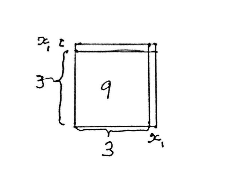

I think it's wrong, since you are going to use square roots a lot, to leave it a dark mystery. It can be done without calculus or such advanced things quite easily. Just use a picture at first. I'll take an easier one, √10 .
Here the area of the big square is 10, made up of a square of the next lowest perfect square, 9, and the bordering strip of unknown width x1, but with total area 1.

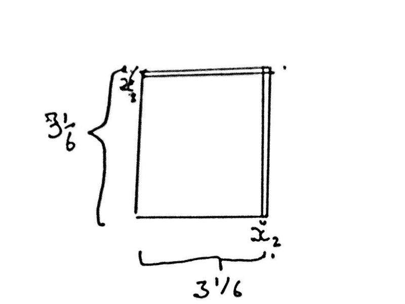

However we can see that a reasonable approximation to the border area is the rectangular strips without the top right corner. Total area of these rectangles is obviously 6 × x1. And as we require this border area to be 1, then x1 = 1/6 ≈ 0.166667 (or other decimal approximation). So the length of the side of the large square is 3 1/6 = 19/6 ≈ 3.1666667. That squared is 10.02778, already not bad.
Make more squares: The outside one is the one we created before, side 3.1666667 and area 10.02778 and the inside one is one with area nearer to 10 we try to create by lopping off that border of area 0.0277. Which we can't do exactly but again the area of the narrow rectangles without the conrner square x2 ×2 × 3.1666667 is an approximation to it - to 0.0277. So we can get x2 .I got 0.004386, Subtracting that from the side (19/6) of the large square gave me 3.16228. and the square of that is 10.00002 - pretty good!
The method is essentially the same as those given by Curieuse and others, at least the idea is, you can have slightly different recipes. But who ever remembers the recipe? whereas I think if this had been illustrated to me with the pictures in school I would not have forgotten it and always been capable of reconstructing it.
